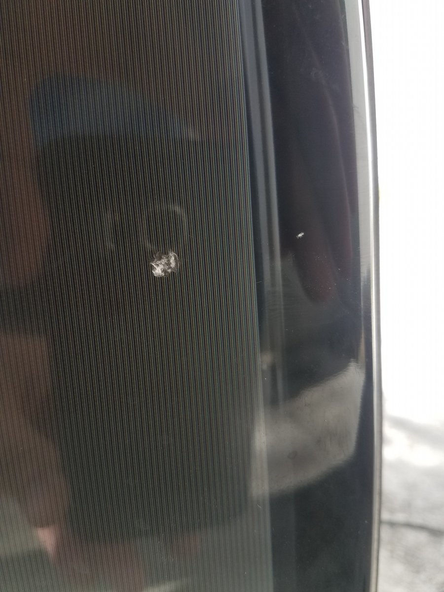

Might need to start learning about tube swapping myself here soon. Was recapping my WG 25k7191 yesterday and discovered the glass has a small chip in it.
Not sure if this can be fixed by some means. When I boot it back up ill see if it's really noticeable. But it's one of those things where I know it's there and it bothers the hell out of me.
So far my search for where to look for replacement tubes is coming up dry but I thought these were pretty easy tubes to find replacements for in America.
