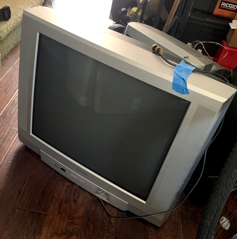

Problem is that this Philips TV produces a great image, and I'm sure that if I remove the yoke I won't be able to set it as good as before.
There's like zero adjustments done with Philips yokes. You literally place it on and make sure it's correctly oriented (as opposed to rotated). Check the first two posts in this thread. Just be careful when removing the yoke. I've heard that the windings can come off.
