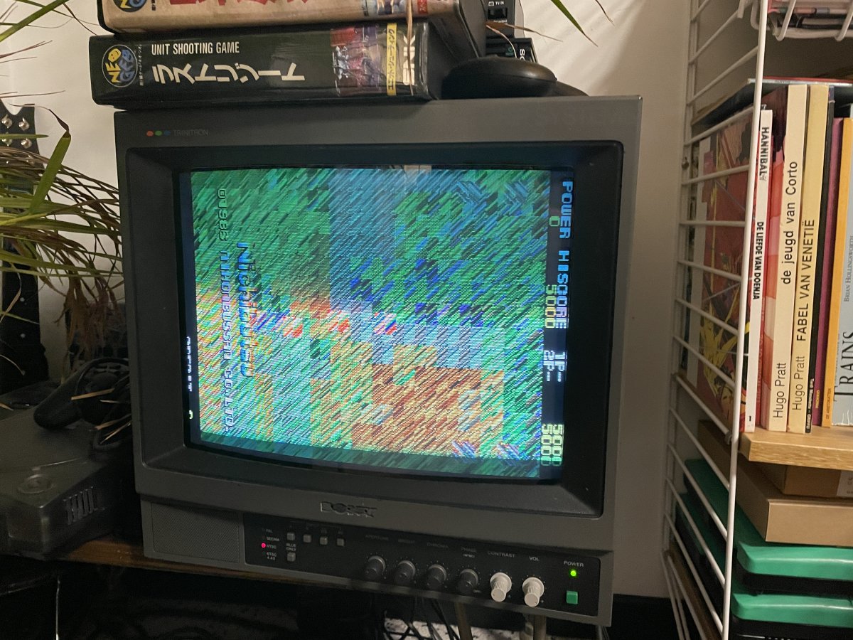

Hi Man,
I tried it on my Dark Soft AES cart and I get garbled graphics. The menu and title screen are totally fine but the game itself has garbled graphics:
Can you verify for me, it's the zip with the crom0 that has a crc32 of 48666C12 that you tested with?
Recommend this:
https://code.kliu.org/hashcheck/
You might need to right click -> save as if using chrome as it might block the exe
After installing, right click on the file, "Properties", and click on "Checksums" tab, check CRC-32
thanks @iq_132 the checksum is correct. I redownloaded it now I get a completely black screen (except for fonts they still show). the actual Neo Geo boot screen doesn't load as well
