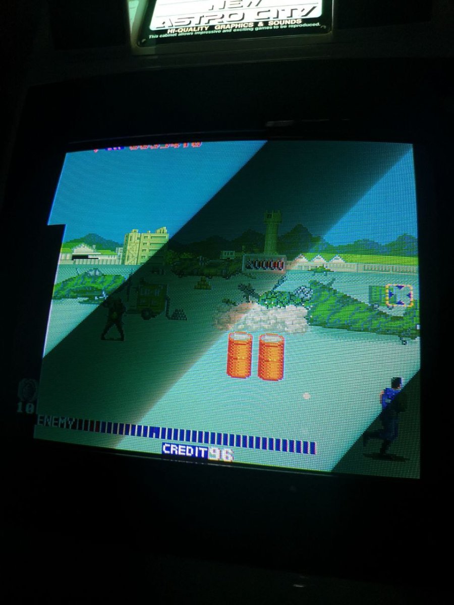

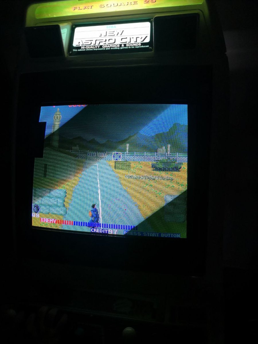

@iq_132 sir , in Cabal , i played 3 or 4 stages and in stage 3&4 also some parts of graphics from screen are missing !
I'm using .neo in MiSTer to play it ! Maybe it happened only me !
Anyway is very playable for me :happy:

I've had multiple people looking at the Cabal rom now, including Ozzy (who is the developer of TEOT Tsunami Edition) and the creator of the neosdconv tool, and we think there is just something non-standard about the rom files (they don't run in AES mode for example) preventing the .neo file from booting on a NeoSD. We've determined that the .neo conversion process is working well with anything else we can throw at it.
If anyone has any ideas for making the roms more compliant, I'd appreciate it, because I'd love to help test on multiple revisions of real MVS and AES hardware.
