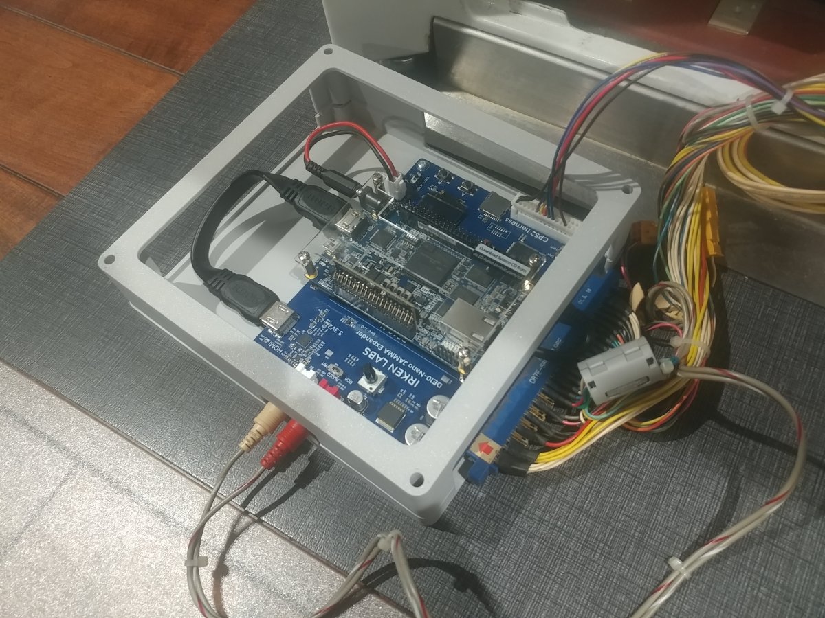

Test fit went well. I'll probably make a adjustment to the bottom of the case where the JAMMA edge is for slightly better clearance. I decided to skip a fan solution since I can just mount one on the DE-10 Nano directly using the existing screw posts and a printed adapter, or use one of those 25mm fan/heatsink/thermal pad combo Raspberry Pi coolers.
Kinda wish the screw holes on the top weren't so deep, but I couldn't avoid that if I wanted to make a support-less model (I guess I could raise the corners and split the glamor line, but I don't wanna :P). The case is pretty oversized due to the included HDMI and power cable, but that doesn't bother me all that much, and shortening the case in whatever flavor of 3D modeling software should be a trivial task. I'll probably throw the STL on Thingiverse once I finalize the model.

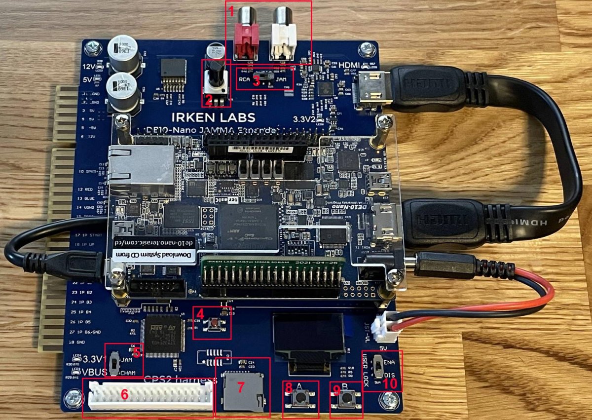

I think this would be helpful. Maybe just an overhead picture with each switch circled and labelled 1. 2. 3. etc and a small text list underneath. I grabbed a picture from online and added some numbers. Feel free to provide info on the functions of each thing and i'll update the list. I haven't even tuned mine on yet, still waiting for ram so i took this info from posts here and irkens site. Let me know if you can fill in the blanks.
This will help cut down on what does X/Y/Z button do i think! Hopefully educate some more people on what each thing actually does.
1. RCA AUDIO OUTPUTS: Stereo left and right audio outputs. Red = right channel / White = left channel (these only work when 3 is switched to RCA)
2. VOLUME ADJUSTOR: Controls the output volume for sound via the JAMMA EDGE CONNECTOR ONLY, NOT line level audio via RCA.
3. RCA / JAM AUDIO SWITCH: RCA = Stereo audio output via the RCA connectors line level. JAM = Amplified audio via the jamma edge, downsampled from stereo.
4, LITTLE RED BUTTON: Unused, only used for initial programming of unit. Just leave it be.
5. JAM / CHAM SWITCH:
--JAM = (JAMMA) 5 buttons via the edge connector, button 6 will be via the cps2 harness. You can also get buttons 4/5 from CPS3 harness.
--CHAM = (CHAMMA) All 6 buttons can be obtained via the jamma edge connector. If you set this mode but don't have chamma wiring, button 6 will always be stuck on.
6. CPS2 HARNESS: Connect your cPS2 wiring harness here to wire up button 4/5/6 ( or just 6 if your cab is wired for buttons 4/5 to the jamma edge)
7. MICRO SD CARD SLOT: Used for saving settings, firmware updates, , storing debug logs when needed.
8+9. A / B BUTTONS: These are used to navigate the settings on the OLED screen
10. ENA / DIS USER LOCK SWITCH: This enables lock mode which prohibits and changes being saved? ENA = Enables lock mode and stops any changes being saved (it will show on oled disaply when this is enabled) DIS = Disables lock mode and allows changes to be saved.
Hope someone finds this useful!
