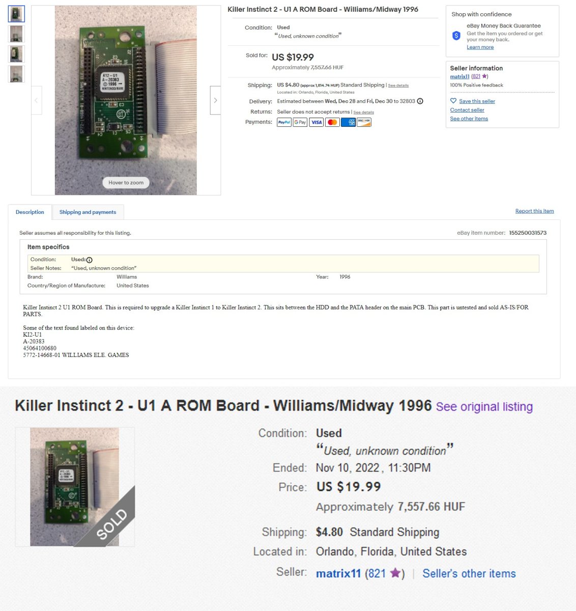

Also shouts out to @DogP, your rom mod to boot KI2 on a KI board works wonderfully. I didn't need to try to hunt down that ide board which I had only seen once and sold recently last month on ebay for $150.
Sometimes it's still cheap even nowadays, there was another one that went for only 20 bucks last month.
https://www.ebay.com/itm/155250031573
Wow! but how often does that even come up? I mean now I have the rom hack but it would be cool to have that for collectors sake. I am still deciding whether to sell my naked non-working KI2 board or try to fix it. I reached out to arcade services since they say they "specialize" in working these boards, I ask a general question but the dude wouldn't answer my question unless I sent an RMA and it was approved. I get he wouldn't field any questions due to a paywall but damn.
