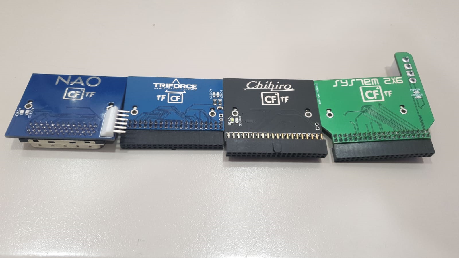

I started working on this CF adapter in my free time
My intention is to make it public so that whoever wants one can make it
I will upload the gerbers and instruction soon
I've also been working on other adapters
Gerber Files for PCB
View attachment NaoCFGerber.zip
Things needed:
2----- 0805 Led
2----- 1K 0805 Resistors
1----- 100nF 0805 Capacitor
1----- 1 Normal CF Socket
1----- 1 Male 50pin SCSI Connector (this is difficult to get)
In a few days I will put the link for the necessary material
I hope you like it
