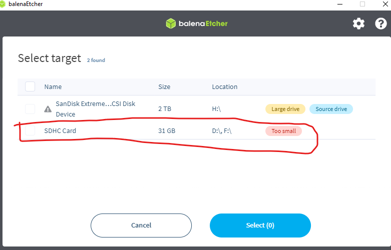

yes i have the IMG file now
But i cant success to work it on Naomi or Triforce.
There is no Network Created.
Balena Etcher gives me the error. It says 32gb SD card is too small

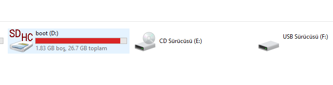

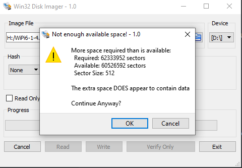

then i burned it with win32image

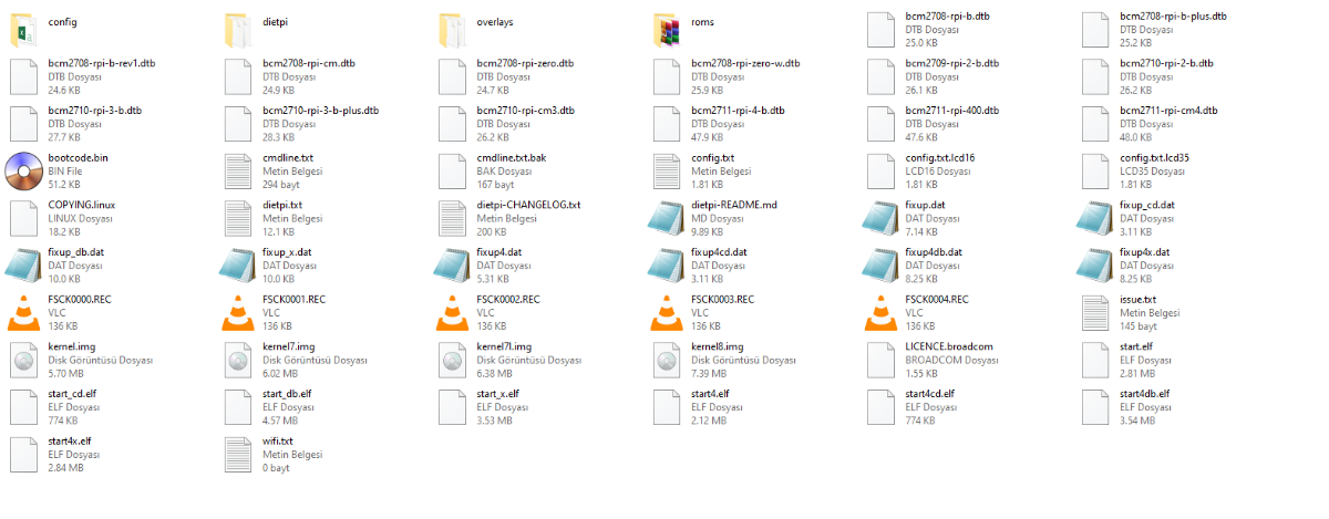

this is how folder looks

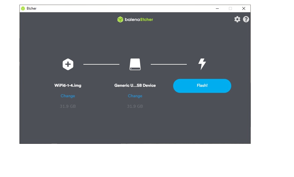

belenaEtcher sees my sandisk ultra 32GB as 31.9, just like the image.

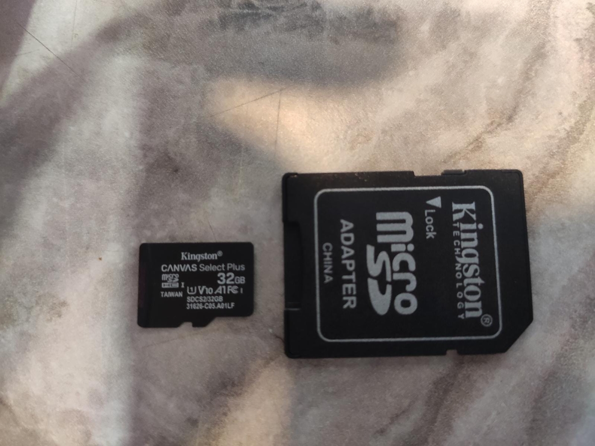

What is your SD card Hursit?

Back to the SD card issues... I can recommend the Samsung EVO (+) ones, always been solid for me.

Yeah not all sd are created equal. I redid my copy so it can fit the smaller 32sd
