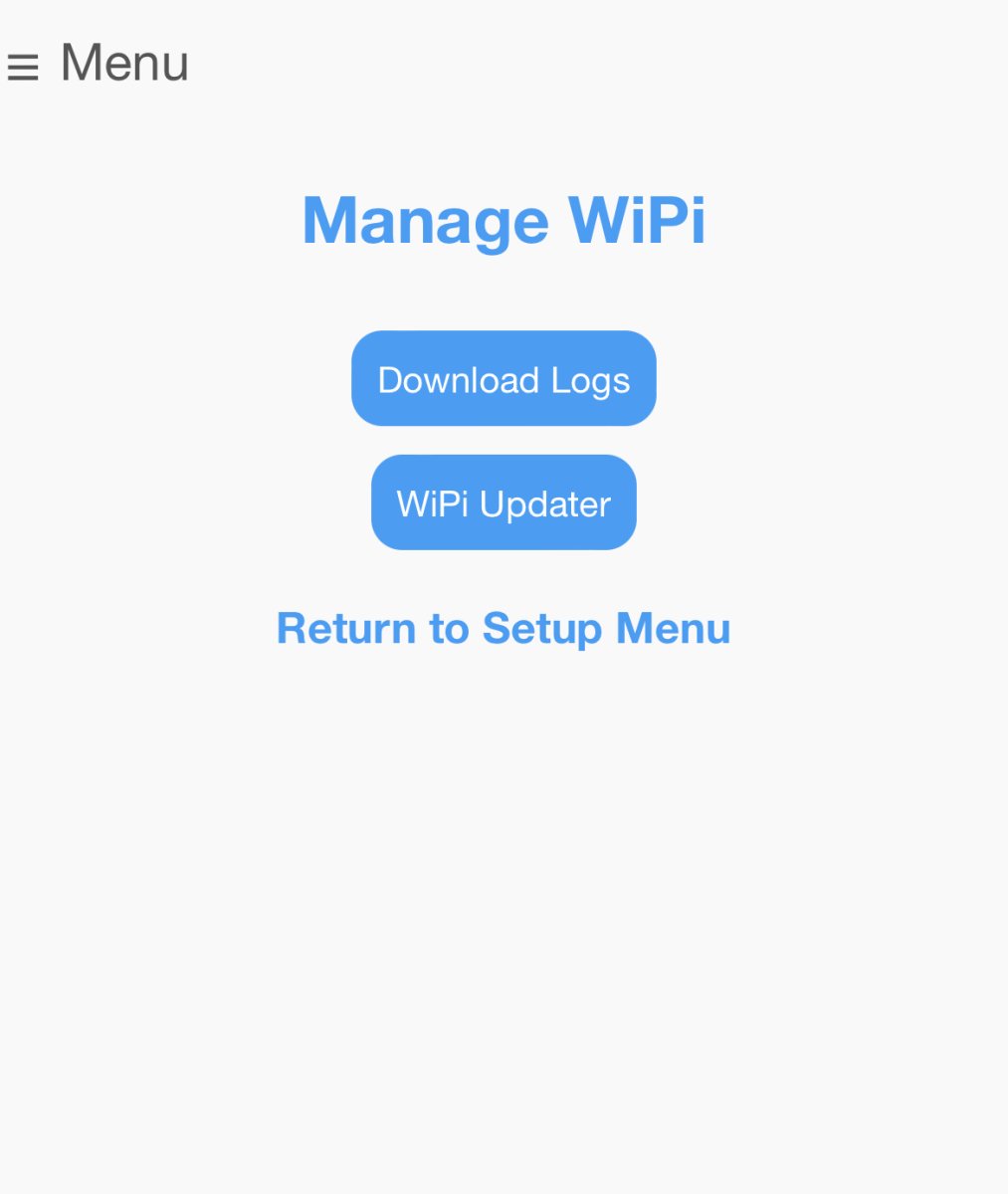

I checked the wipi version and I am on 6.1-4.

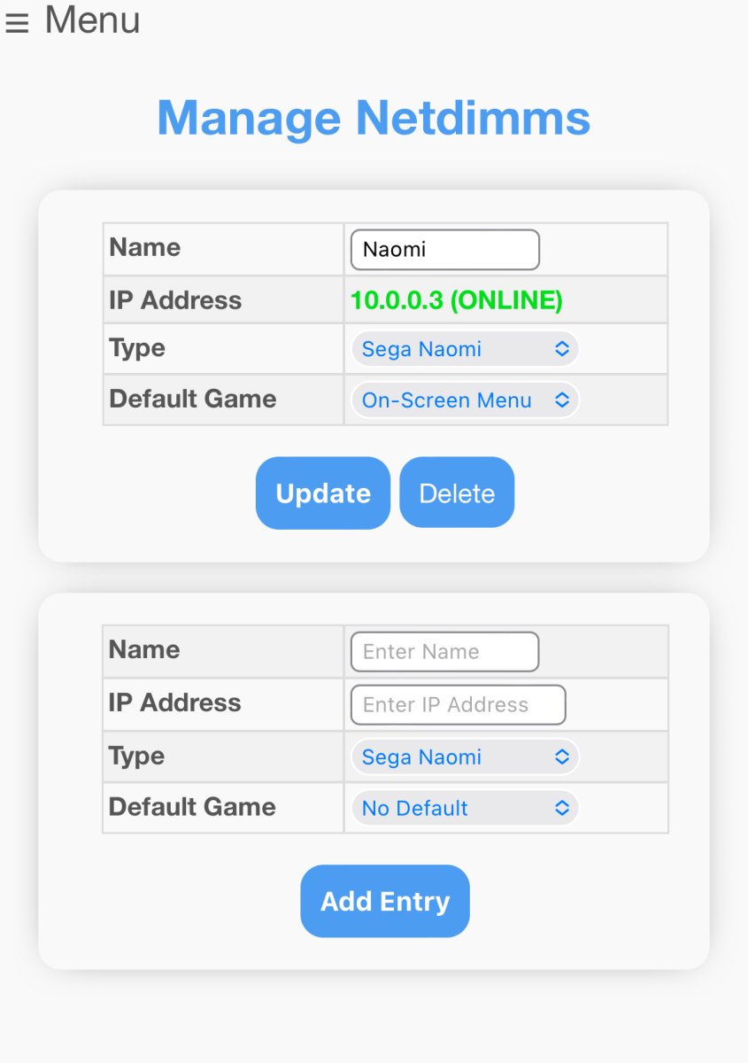

I was able to change it to on screen menu, however when I power down the system and turn it back on, the naomi boots back to the last loaded game. I have then disconnected the Ethernet cable and connected the pi to the router. It get a message that there is no internet connection.
What can I do to get the osd menu running and how can I update the wipi?

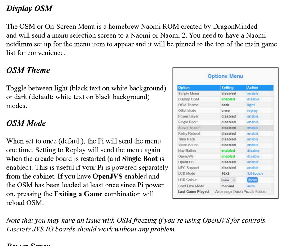

  • Check the Instruction Manual - There is a Link in the official Github (scroll down to the text) - Read Page 3 - There is an explaination how to setup the OSM (i called i OSD) for being available on reboot
  • It is good to slowly read through that manual, here are a lot of hidden gems/information in there :)

My Naomi is powered externally, so I believe I need to enable the replay mode.
In regards to updating the Wipi, instead of connecting the Wipi and the Netdimm to a switch and then to my router, could not just connect the Wipi via WiFi to my home networ? Will this allow me to update the Wipi?
I will continue to fiddle around with it.
WiFi should work as well. Check the handbook and the information on the network configuration page. :)
@Orakelschaf
Yeah, WiFi worked and I was able to update the Wipi to 6.1-9.2.
I also enabled the OSM and changed it to replay mode.
Then I set the Wipi back to hotspot mode. I am still not able to see the OSM when I boot up the Naomi. It still boots up the last game.
