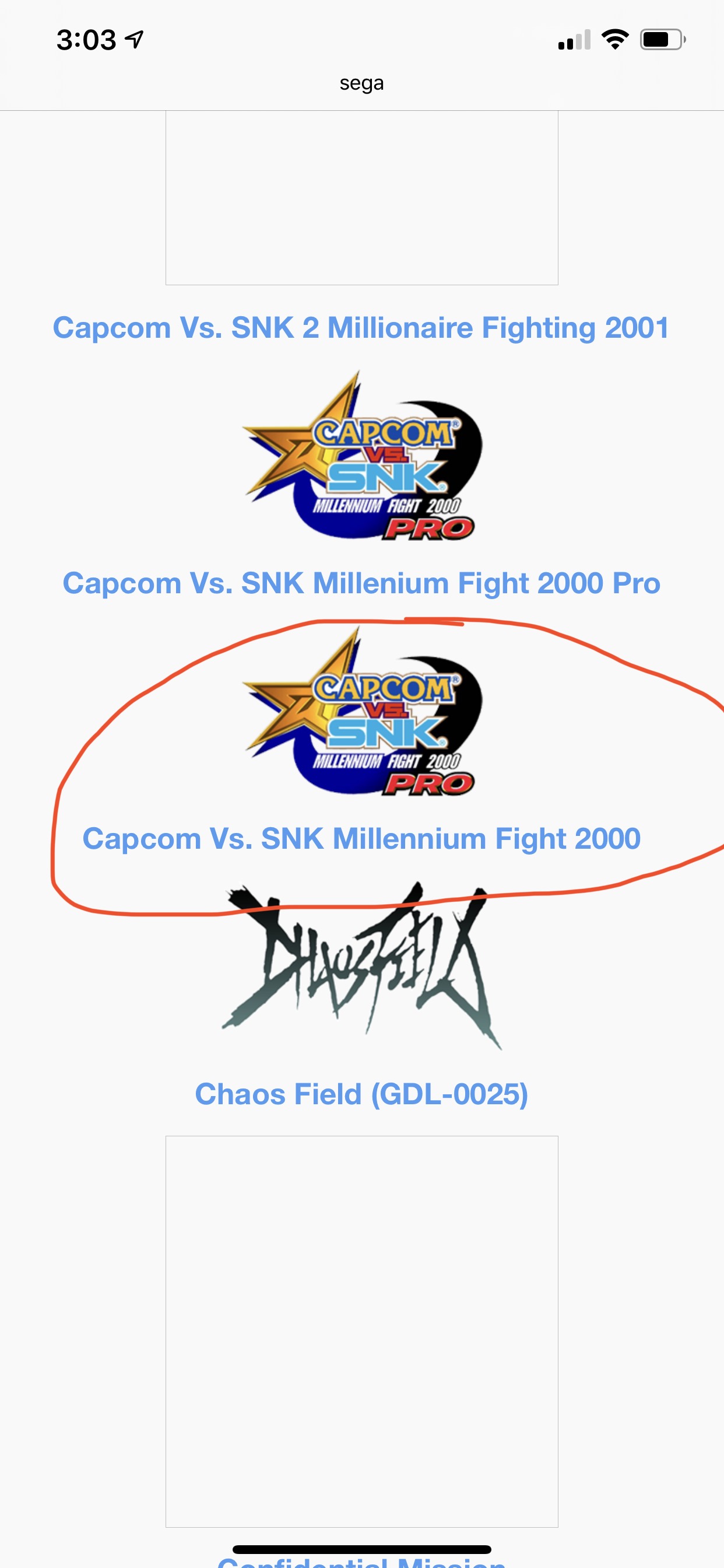

Having trouble with the image for Capcom Vs. SNK Millennium Fight 2000
I changed the name of the image to capsnk.png in the csv file, but it is still displaying the incorrect image.
What am I doing wrong?
I think I figured it out, "if you edit the file, run the import csv function under Setup to copy your changes."
