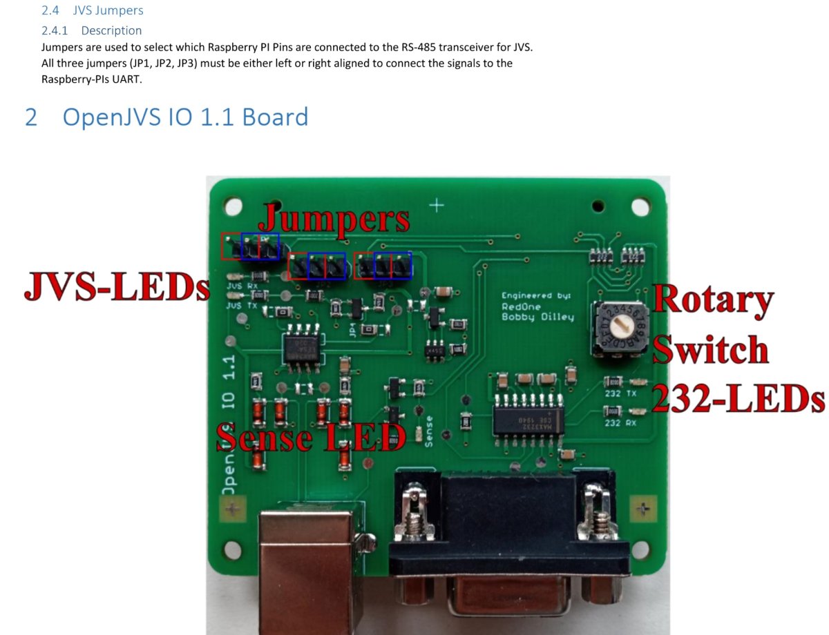

jumpers: the manual says to set them all to the "blue position" for non Pi 4.
Thank you for the help.
I have switched the jumpers to the other position.

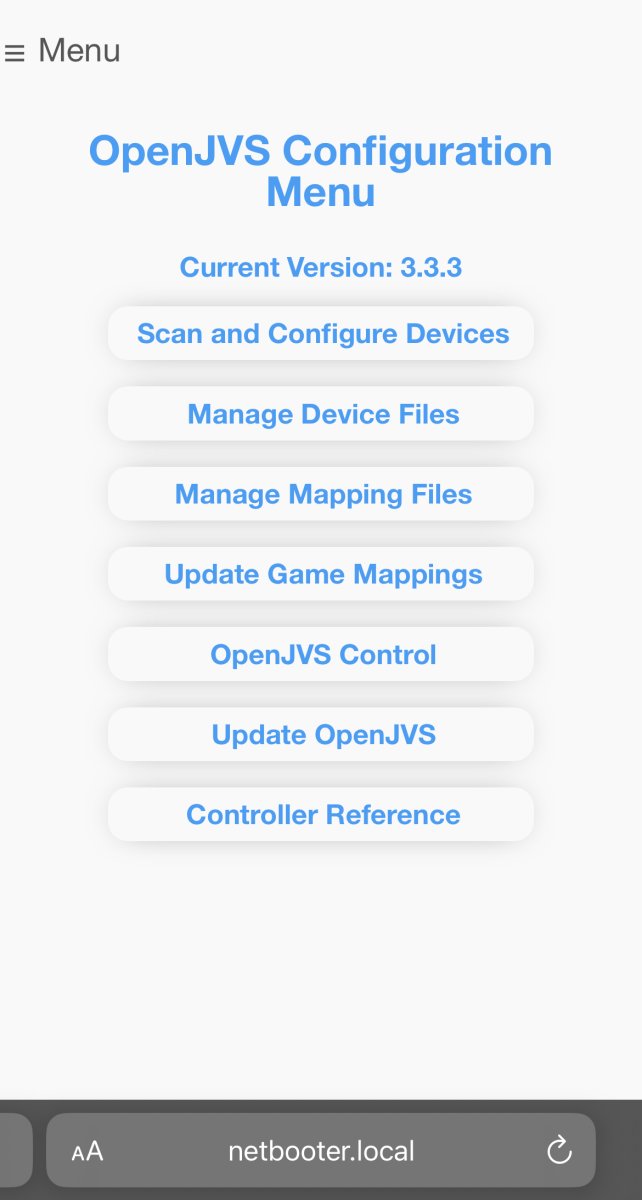

I did see the Bluetooth devices configurations menu, however it disappeared. I am not seeing it anymore.
How can I get it back?
Although this screenshot shoes 3.3.3, I was able to update it to 3.7 but the Bluetooth device configuration does not show.

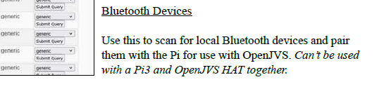

From the wipi manual:
Bluetooth Devices
Use this to scan for local Bluetooth devices and pair them with the Pi for use with OpenJVS. Can’t be used with a Pi3 and OpenJVS HAT together.

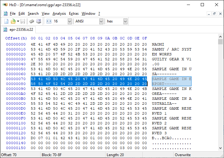

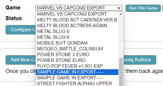

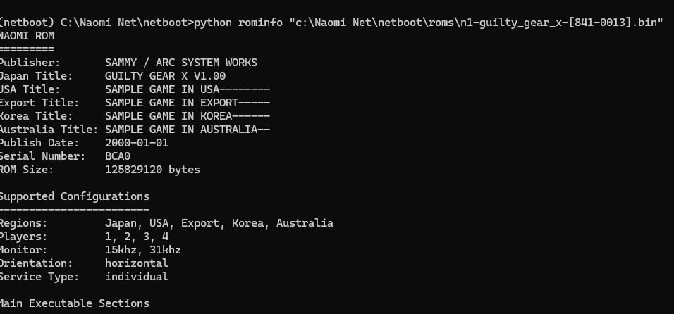

For the roms in the wipi pack, some show in the game list display at SAMPLE GAME IN EXPORT and I found the same using the rominfo command. Is there a way to change this information, so i can update how its displayed in the game list? I am assuming its using current bios selection to tag the name, so if i changed to japan bios it would be correct with Guilty Gear x V1.00. I am running the H Multibios, I thought it was adviseable to use export but could be wrong there.
