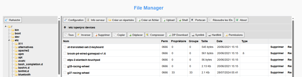

Is it possible to set the rotation to 270° the g25 or g27 steering wheel in openjvs of wipinetbooter
Thanks
To answer my question
yes yes who seeks finds
Here is my config file for the g27 steering wheel
just add "SENSITIVITY 0.3" like this
ABS_X CONTROLLER_ANALOGUE_X SENSITIVITY 0.3
Test with the g25 and the g27
Best regards

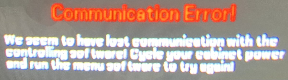

Recently I have been getting communication errors when trying to boot games from the On Screen Menu.
Launching the games from a web browser works fine. I prefer the convenience of the OSM being able to set Freeplay from the get go.
Originally this worked fine. I haven’t powered on the Naomi for a while. Prior to this some games launched and some didn’t. Now none of them launch anymore.
It would be great if someone could share their experience and provide a solution.
Thanks in advance.
Communication error!
We seem yo have lost communication with thr controlling software cycle your cabinet power and run the menu software to try again wipi

Hello Fellow Wipi Netbooter Enthusiasts,
Thanks in advance.
I had this same problem, my Pi is on 24/7, first thing i did was rebooting it but didn’t solved the issue, then i opened the cab and noticed it was running a little hot since something was obstructing its airflow, relocated the pi and everything worked ok after that. I know this may not apply to you but that was my experience.
@elrod
Thank you for the tip. I have a feeling that it has some mechanical problems too. I’ll probably have to take it out and reseat it.
I’ll let you know what happens.

I wasn’t able to get the OSM back to work. How can I backup the current image to format the Micro SD card? Also, can the improved Atomiswave roms be installed onto the Wipi image as well. Retro RGB reported before that there are improved Atomiswave roms that have taken care of some of the slowdowns of these games.
