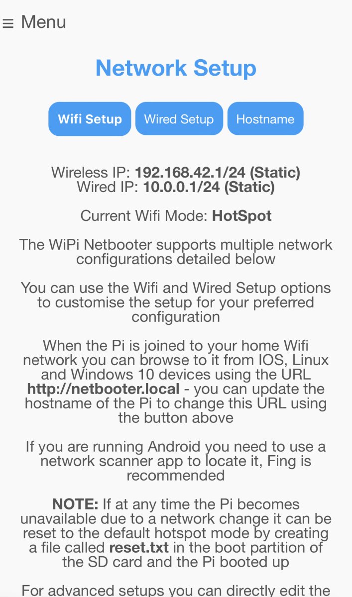

How can I reconnect to the Wipi?
If the WiPi is still connected to your wifi network you can access it by the ip given by your router. If you successfully changed it back to hotspot mode you should finde the wipi network. - You can reset the network with a file you can put on the sd card - Please check the manual for the correct naming. (check MrHide's answer, he was faster :D)
Did you choose single boot to enable? If so what is the setting for the default game in your net dimm configuration., Guess it is "last game" :)
Thank you very much for the help and looking into the manual @Mrhide and @Orakelschaf,
I have gone through the manual and tried to look into the reset.txt.
I believe the explanation is part of the screenshot of the Wipi Web interface, thus I was not able to find it in the manual directly.
To create the reset.txt do I only need to create a file and name it reset.txt with nothing written in the actual txt file? Or do I have to copy and paste an script in that?
Thank you for the quick reponse.
So I guess I am just going to drop reset.txt into the root of the SD card. I will then look for the Menu in the game list and boot it. Then, finally I will be able to run the OSM and setup free play from the menu instead of pressing the two buttons on the Naomi. Looking forward to that.

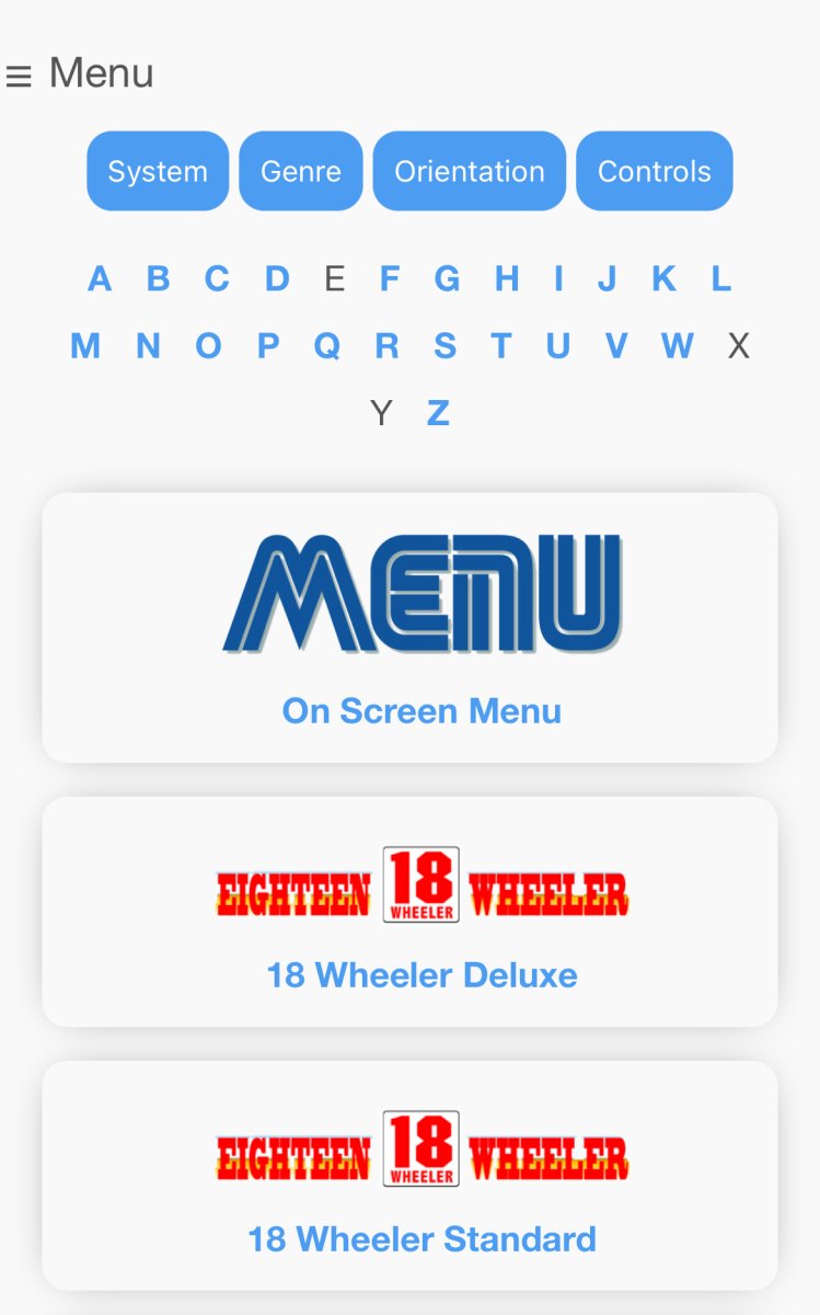

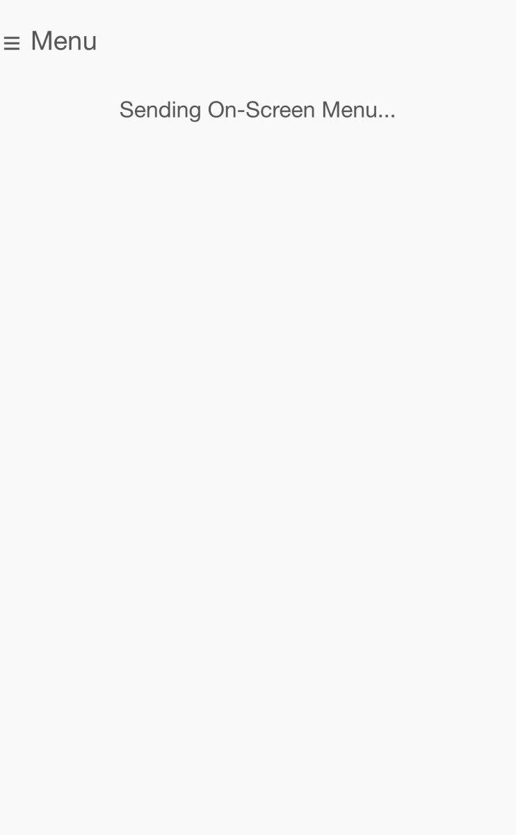

I have tried to load the On Screen Menu (OSM) from the game list but nothing happens.

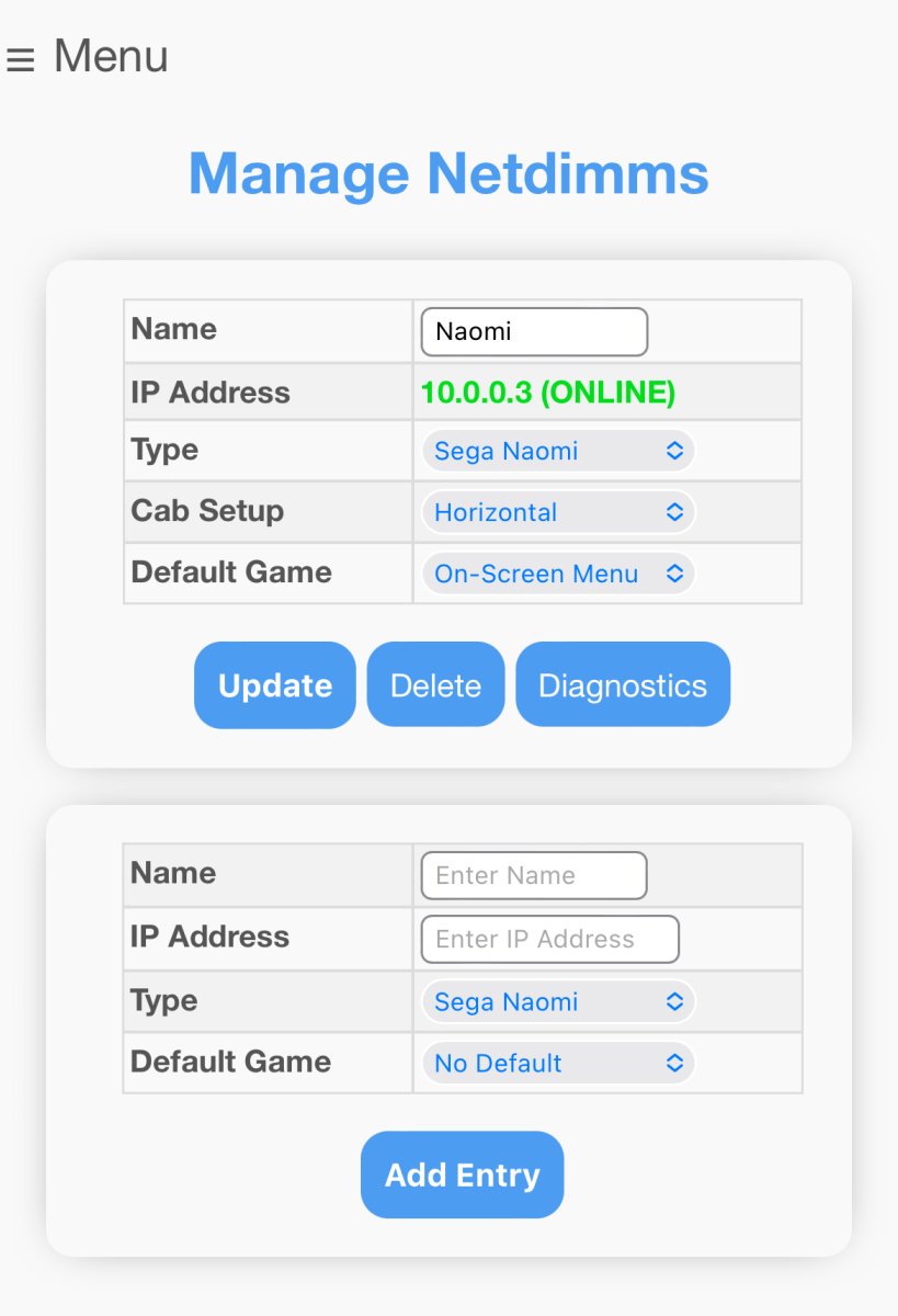

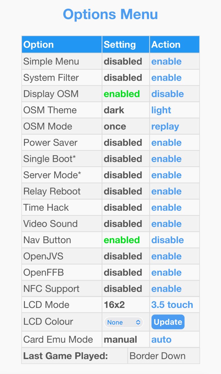

I have set the OSM as the default game in Netdimm manage and enabled it in the options menu.
Please see attach the screenshots of my settings.

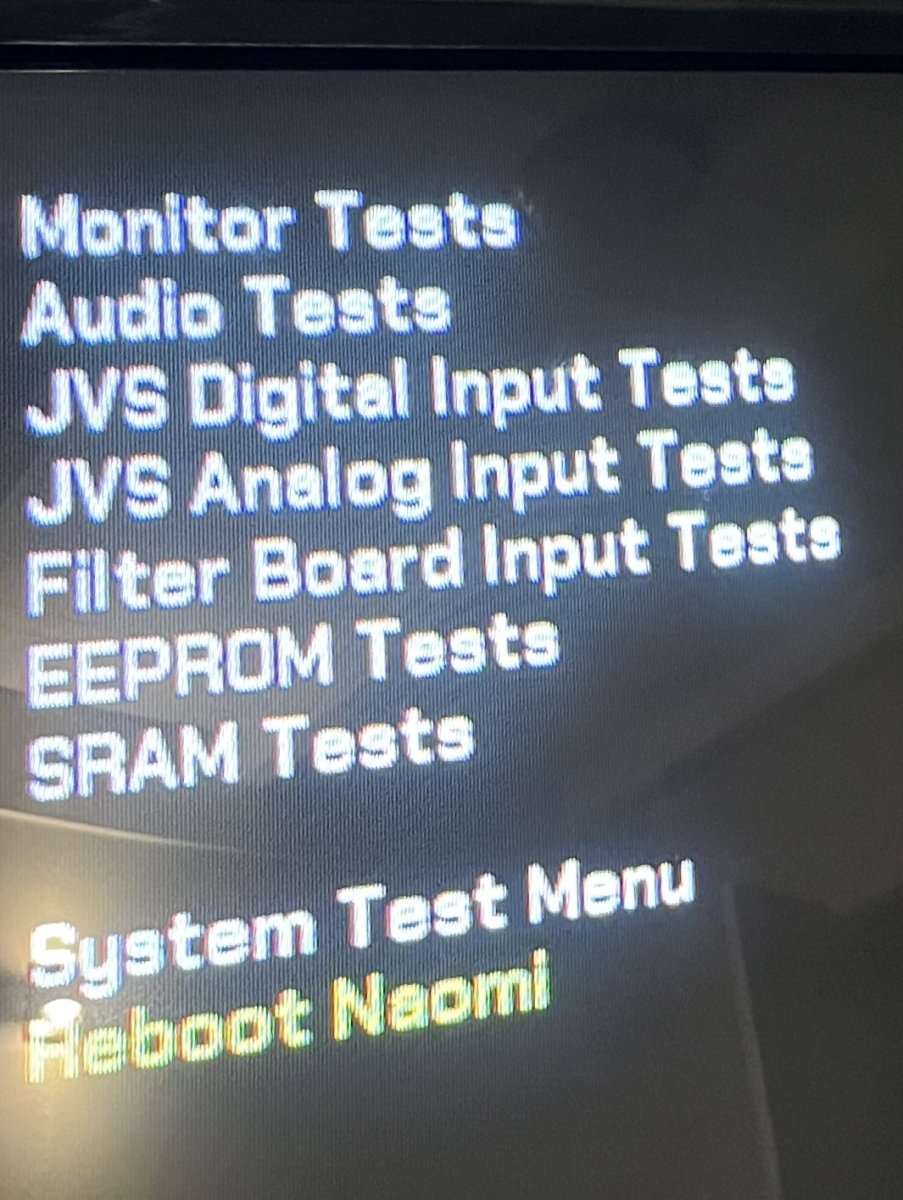

The last picture shows you how I got into the diagnostic settings.
How can I boot into the OSM?

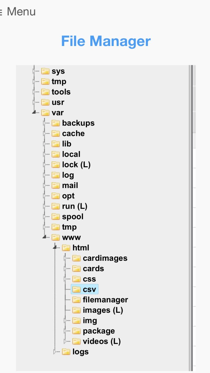

Where do I have to go to get into the csv file folder?
How can I make these changes?

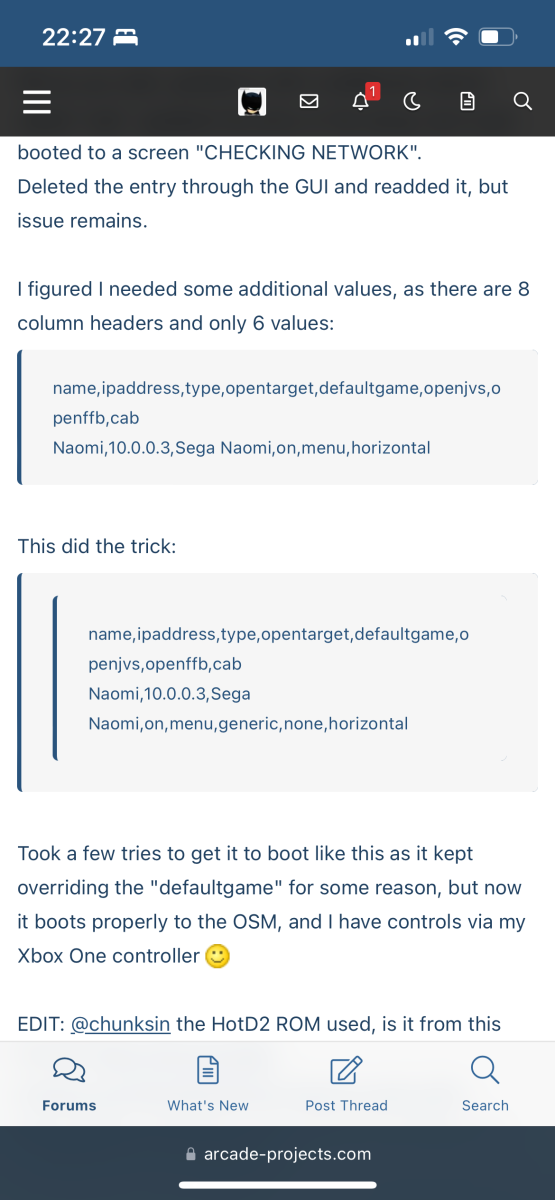

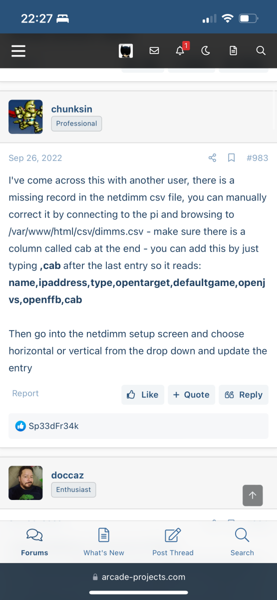

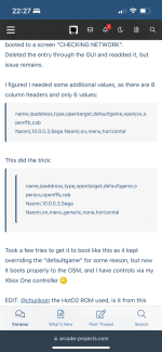

Thanks for the quick reply, appreciate it. Just got the chance to take a look at it, and found this in the dimms.csv file:
Did as you said, updated it with a additional column called "cab", updated the entry in the setup, but it just booted to a screen "CHECKING NETWORK".
Deleted the entry through the GUI and readded it, but issue remains.
I figured I needed some additional values, as there are 8 column headers and only 6 values:
This did the trick:

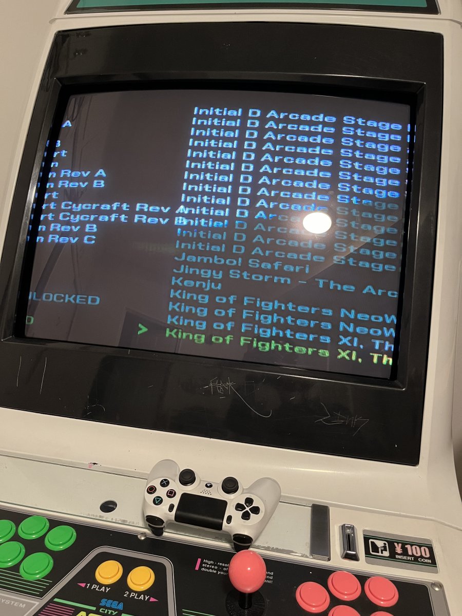

Took a few tries to get it to boot like this as it kept overriding the "defaultgame" for some reason, but now it boots properly to the OSM, and I have controls via my Xbox One controller :)

Thank you so much for figuring this out.
I was finally able to do this too.
All you need to do is to ideally use a laptop or computer and connect to the Wipi.
Then go to file manager and find the dimm.csv file. There you edit it as described. Save it.
From there I went to game list and booted the Menu.
It worked!

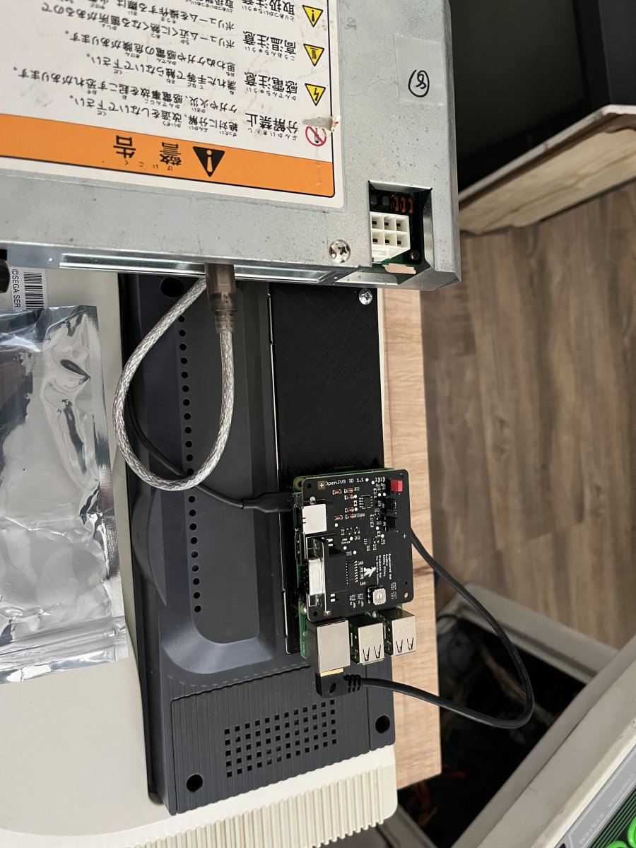

After I connected the the usb b connector to the OpenJVS hat instead to the Capcom IO, the image is not synced anymore.
Why would that be? The monitor is connected directly to the VGA port of the Naomi.

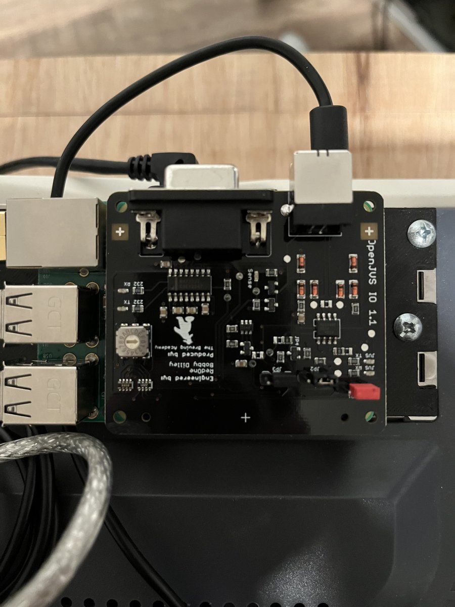

Also, I have a Raspberry Pi 3 and am not really understanding the jumper settings. I have left everything at default.
Do I need change the jumper settings to make it work with my Raspberry Pi 3 and Jamma setup?

after I connected the the usb b connector to the OpenJVS hat instead to the Capcom IO, the image is not synced anymore.
You have completely unplugged the capcom IO right? it's not needed at all in this setup. ( meaning you need to plug usb or bluetooth devices in the pi ... your cab joysticks and buttons will not work). You had the monitor plugged in the vga port of the naomi while using the capcom io ? but you also had the jamma plugged in so perhaps the sync issue is coming from the jamma beeing unplugged?
jumpers: the manual says to set them all to the "blue position" for non Pi 4.
