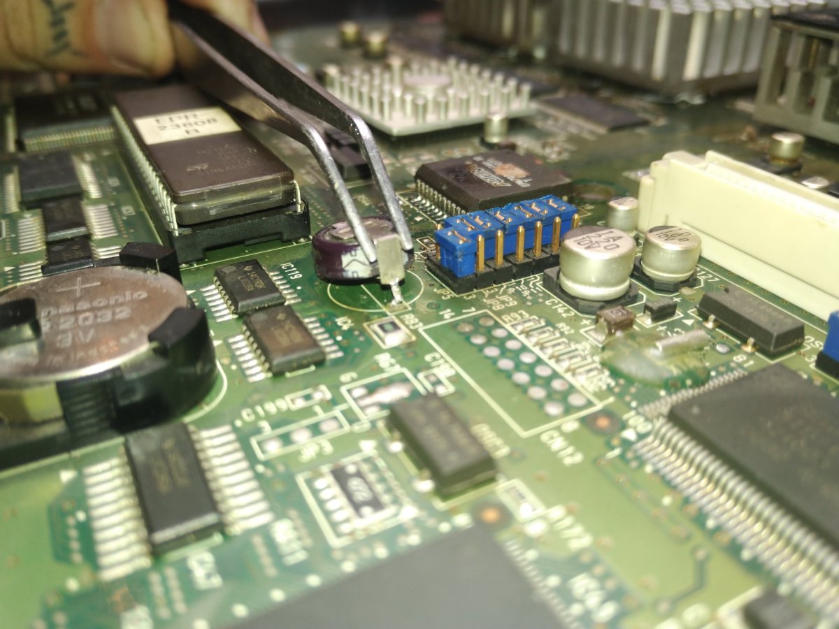

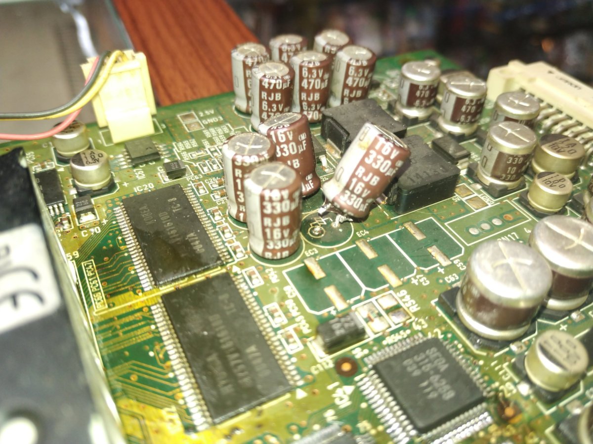

um. so. hey all.
the super cap on my n2 is almost completely lifted away from the mother board...
this of course cannot be a good thing. at all.
but wouldn't this certainly be the cause of all my issues?
and upon closer inspection there was this other cap here that was so oddly soldered in that when i prodded it very lightly it just snapped...
jesus christ... the fuckers i bought i this from have almost certainly been feeding my headache alone.
also what in the hell is going on over here?? (pic 3 and 4) some kind of modification or did they just leave some junk laying across the soldering paths?

the Naomi 2 complete with the netdimm, I buy it all together or separately. If it's together, you shouldn't have disarmed it. he should have returned it to the seller so that he can respond for the damaged or in poor condition product, something similar happened to me, I simply returned it and they returned my money, or have demanded a change of product, now if the guarantee has already expired, could you show how is internally the dimm with cf
I bought it pretty recently so it wouldn't be a big deal.
But nothing else really seems to be the matter besides these weirdly replaced components. If anything I might try to seek a partial refund because I don't think this is outside my abilities to fix.
If it's just the caps that are loose or floating then not at all. I'm mostly just confused what the hell that little piece of wire in the picture is. I don't want to remove it if I can get some info about whether it's some kind of mod or if it was just a mistake. Or if I can get a full refund without having to return the unit I'll go ahead and get a unit I'm much more confident is in better condition.

N2 cart slots look super clean. NetDimm cart looks super clean. No bent or corroded pins. My N2 board is like brand new. No obvious damage. Even my supercap looks good.
those chinese naomi 2 that they bought on ebay or aliexpress are all very worn, I honestly tell you more than one will have problems with the naomi 2 games, I recommend doing a complete re-cap. to prevent the problem from continuing

I'm going to get in the shop tomorrow probably and start attempting to fully set that super cap in place.
the other cap that fell off i'm going to need to order a new one.. i don't trust myself try to solder that back in with such short legs now...
then we'll see how well the n2 maintains a constant voltage..
everything from the screen turning to black after a successful boot to the splash screens changing made a bit more sense knowing some of those caps were barely even making contact.

things suddenly made more sense once i popped my n2 open entirely.. very very nasty
i still haven't gotten a word back from the guy i bought mine from so i think i'm going to contact ebay directly and hopefully get a full refund...
