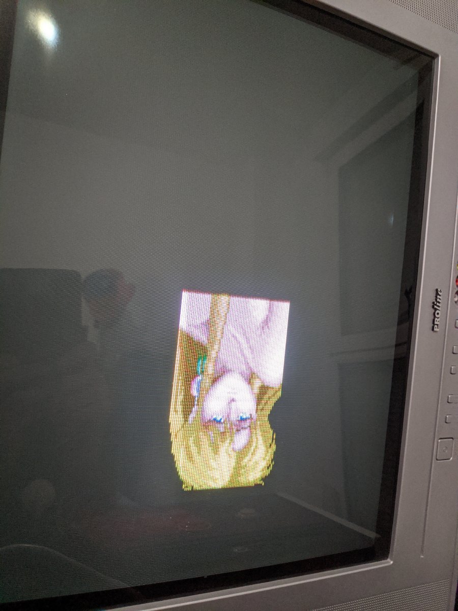

just tried, just blue and yellow screen flashing on a loop, no music, sound or game
I had something similar when I first assembled mine, it was due to poor contact on some of the pin headers. removing the main multi board from the top board and re-installing it ensuring all of the pin headers (especially the ones towards the center of the board) were fully seated. For whatever reason I couldn't get them to seat all the way without separating the boards first.

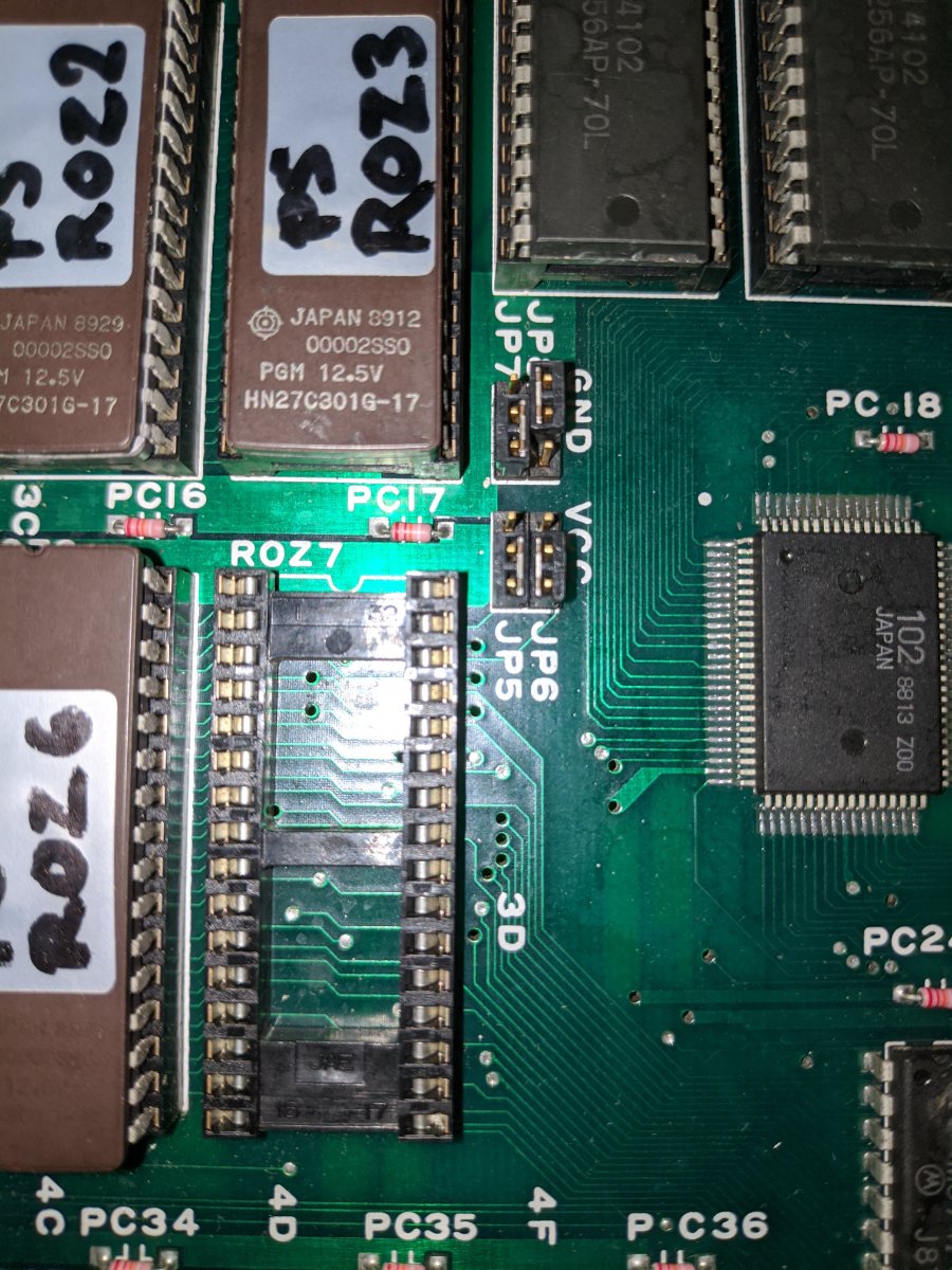

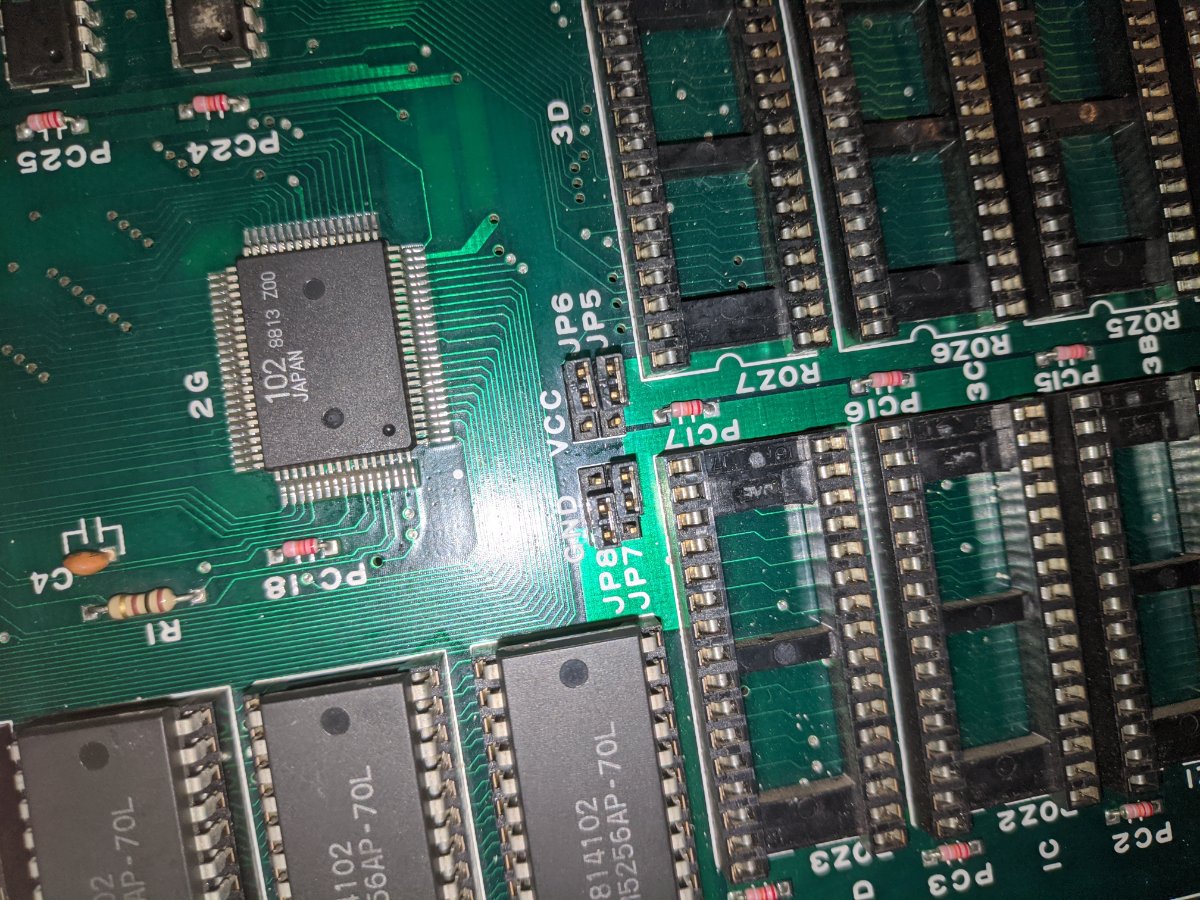

@Darksoft … big thanks . the Namco System 2 multi is perfect working . Not any issues here , is super easy to install the kit (i did it hy looking in your almost perfect instruction manual installation notes) , perfect fit in sockets on both boards . Also is lovely to use Proman 🫶🏻

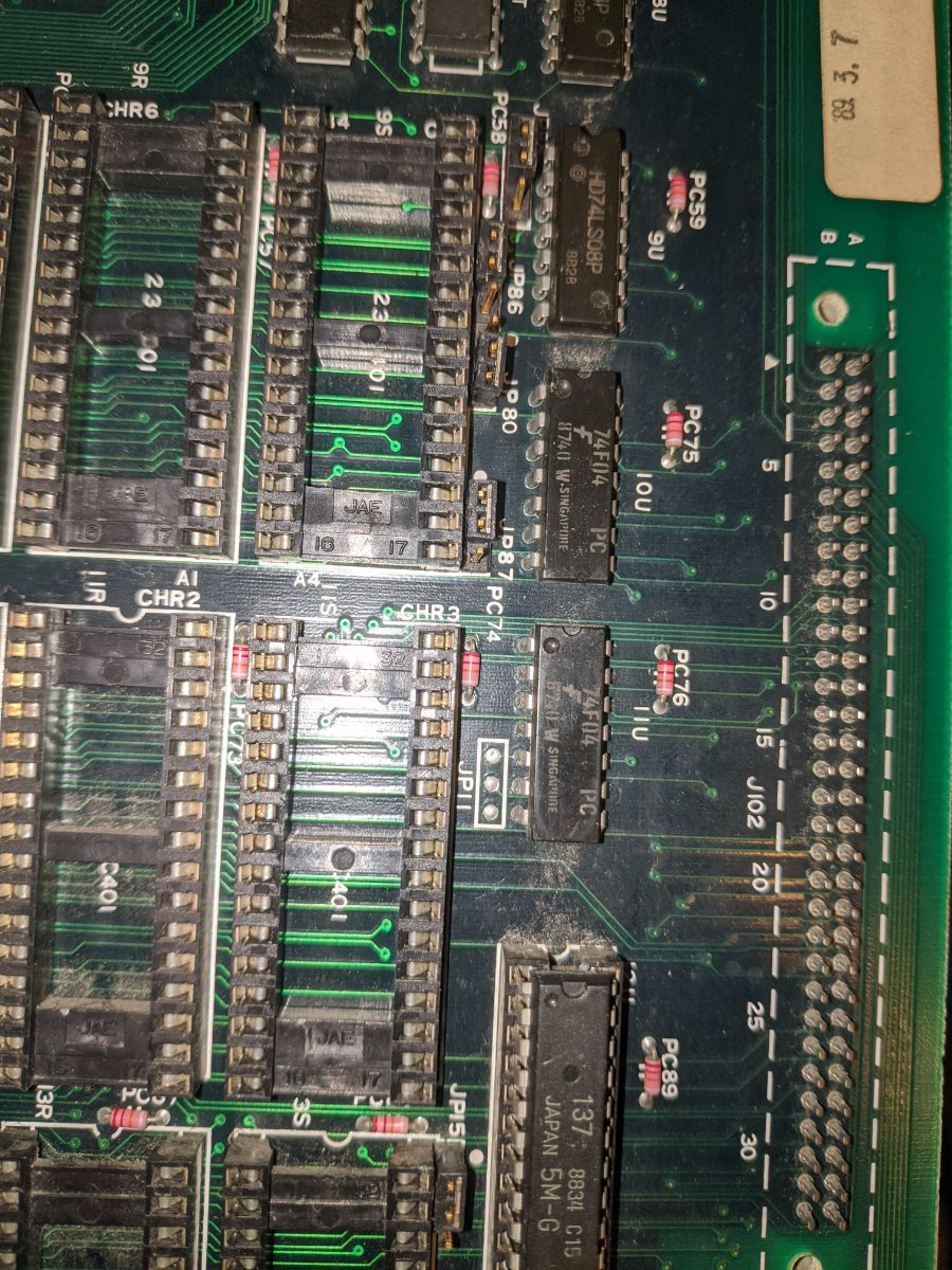

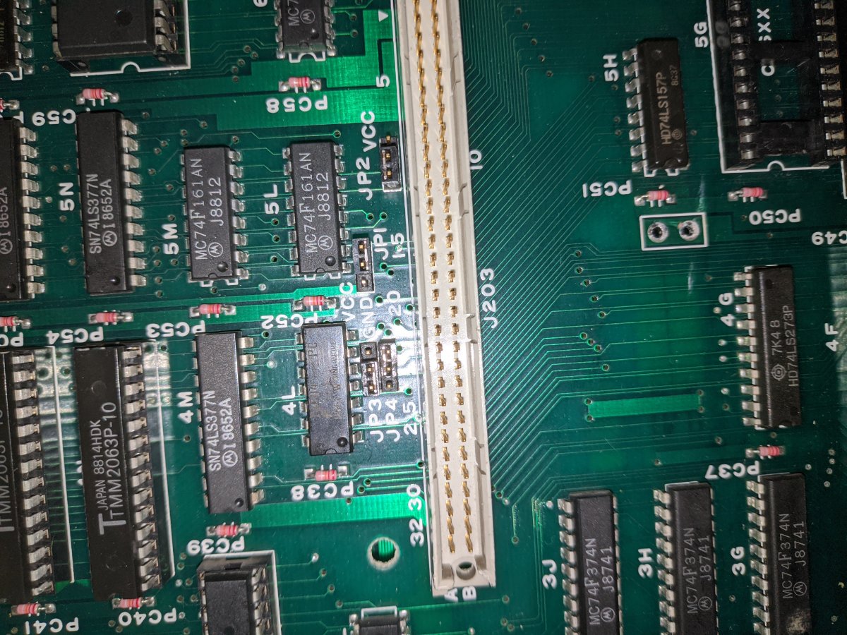

Only when update the manual , on my donor (on motherboard) , on the back of 2E logic ic (HD74LS244P), we have JP18 - is set on GND not on VCC . ive seen this mentioned by @Mrhide too . I did namco sys 2 conversions on both motherboards models and i forgot mine had this jumper 🤷🏻

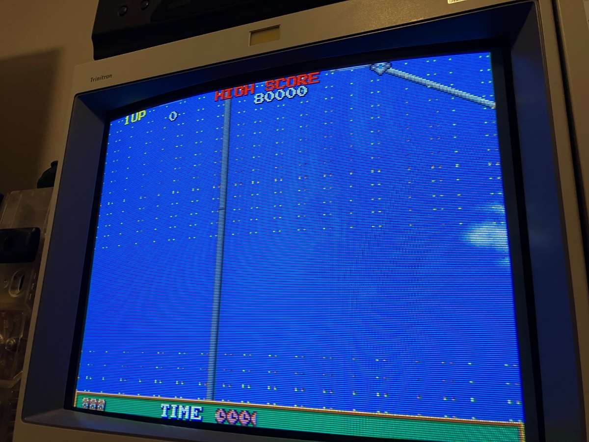

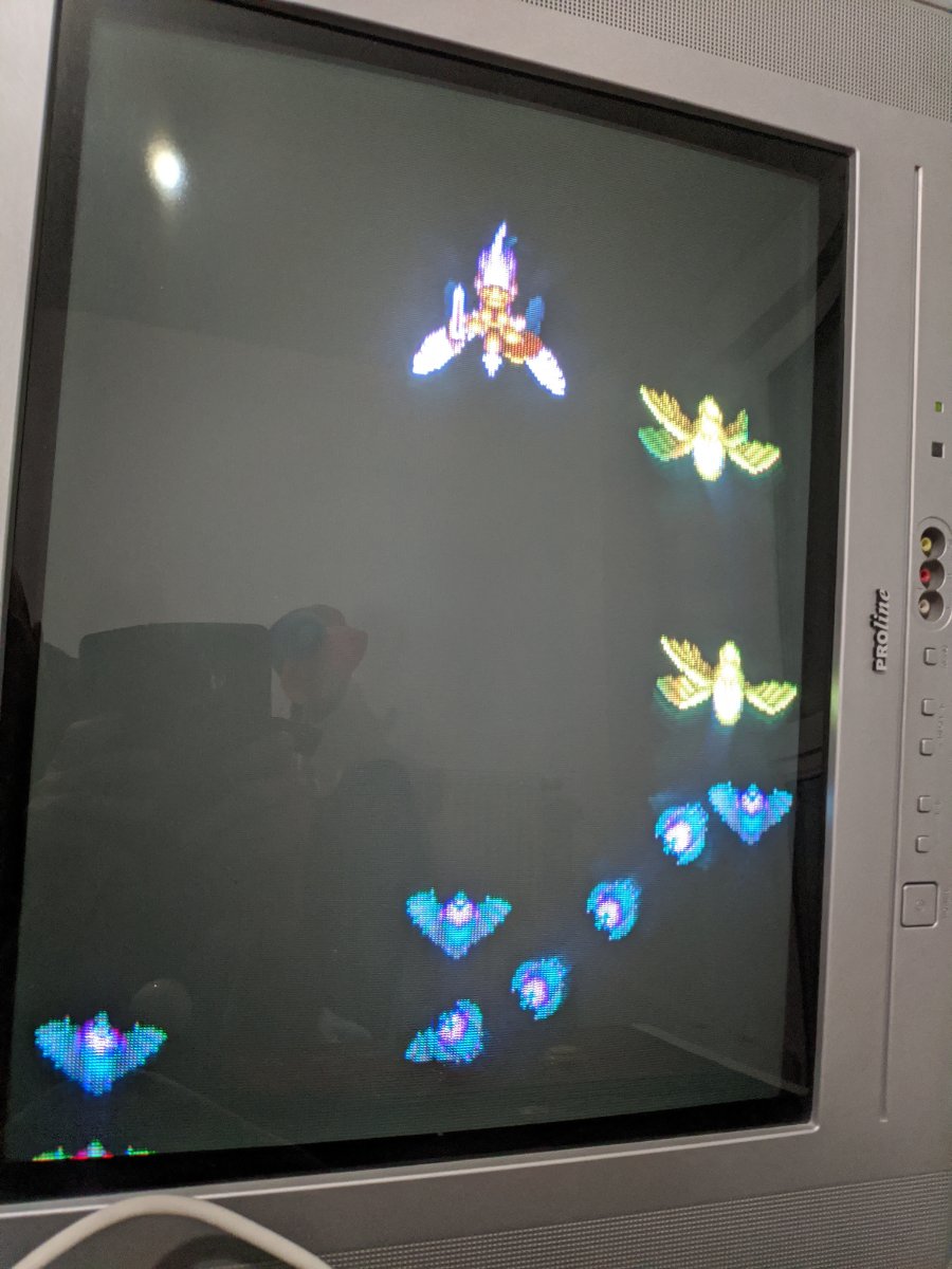

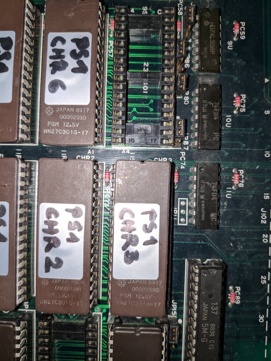

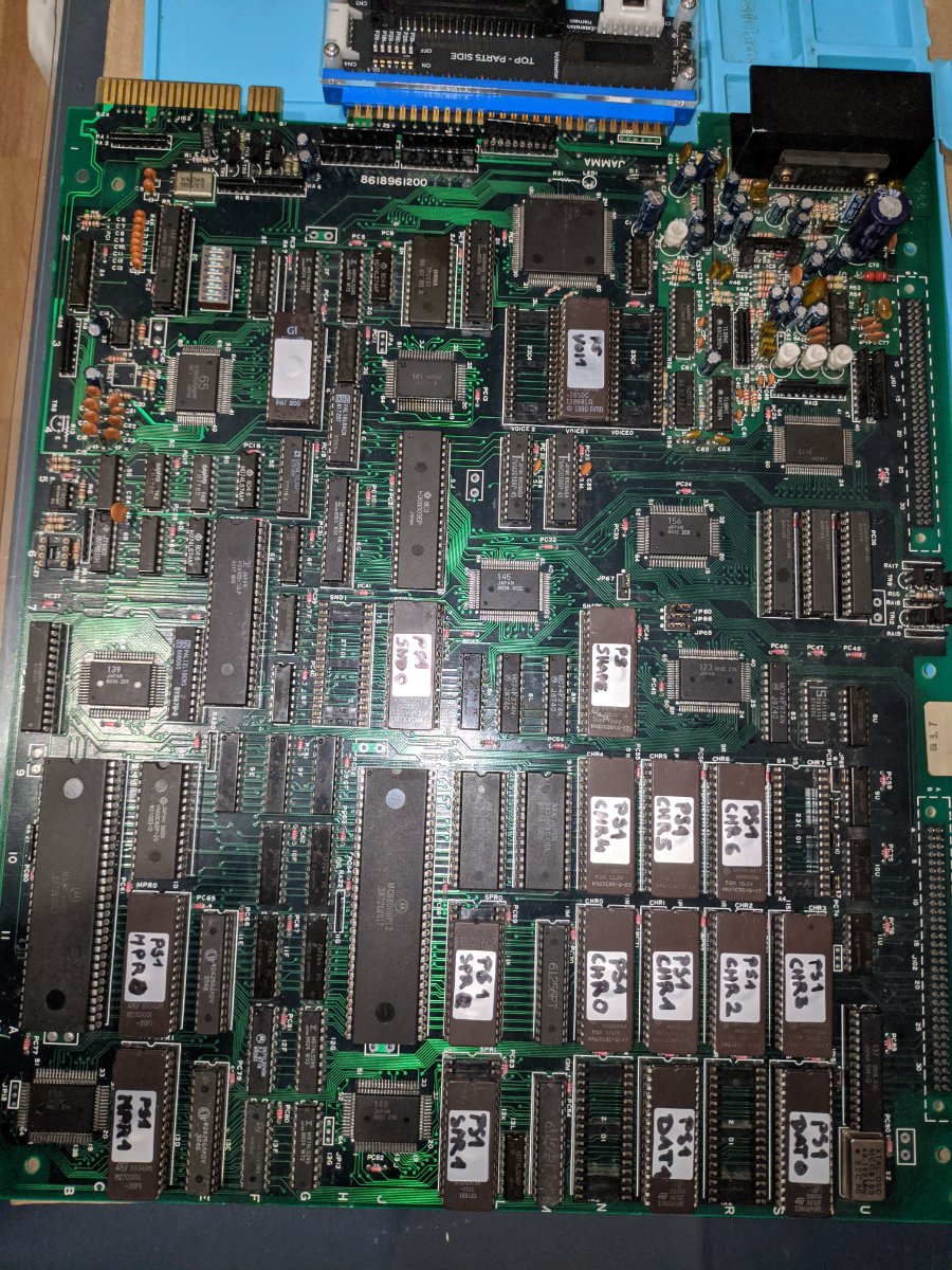

well...I went back to square one, removed the multi, removed every chip from every socket and clean the whole pcb with iso 99% alcohol and wd-40 "contact", set it back to the converted Phelios it was before, but I only gets sprites, bullets, sound and music, no background or text 😢 (made sure chips and boards are well seated together)

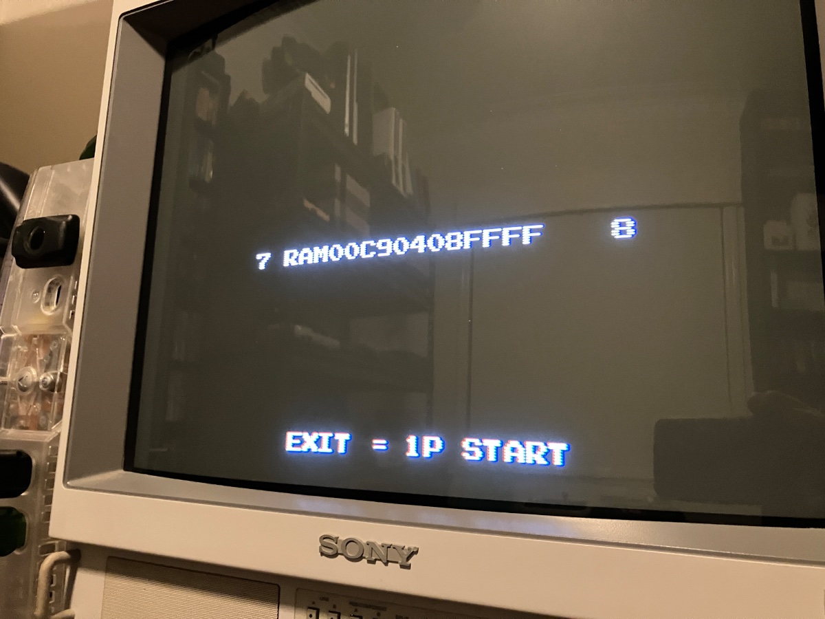

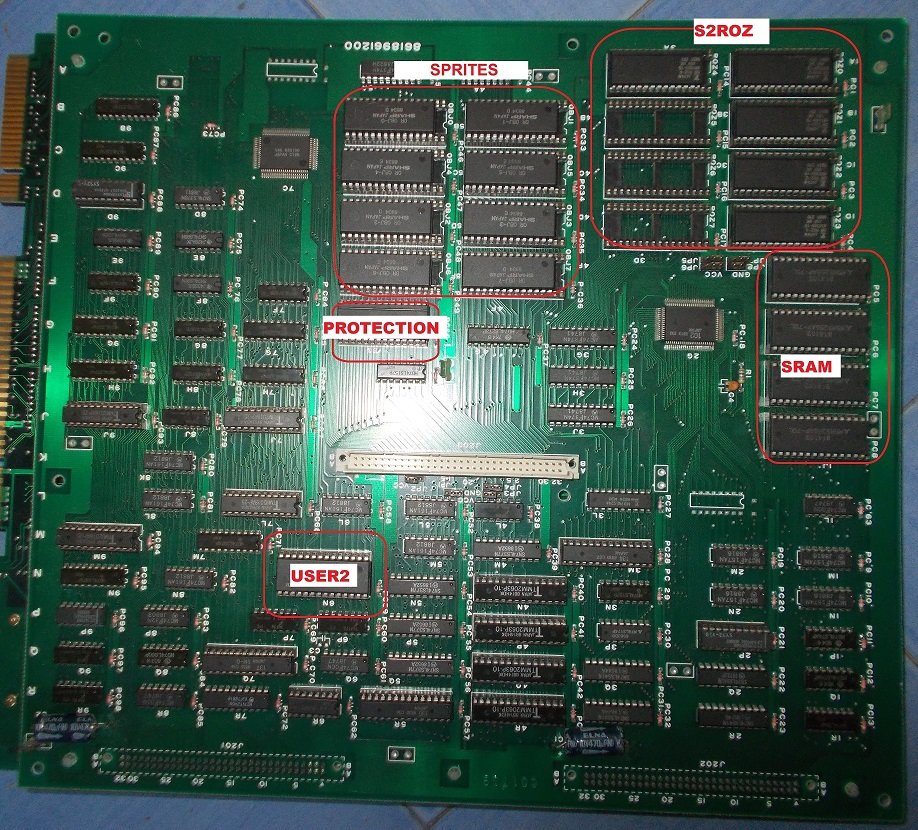

Got the multi all put together, and I'm really close to having everything working. Pretty much all games on boot show "33 Tip" after the RAM test, and a few others say 34 or 35. Everything sounds and plays great, but some effects and graphics are missing (Large vehicle in Rolling Thunder 2 first stage is completely absent).
My donor was a working Ordyne. Jumpers are all set right, and I've reseated the pcbs twice. Going to try cleaning the sockets next. Is there a particular area to focus on for 33 Tip error?

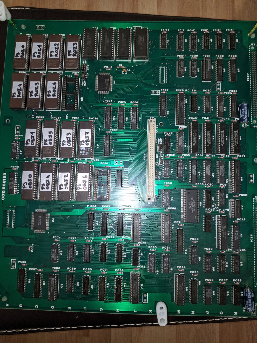

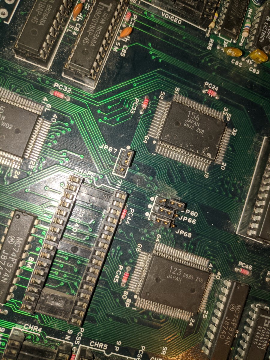

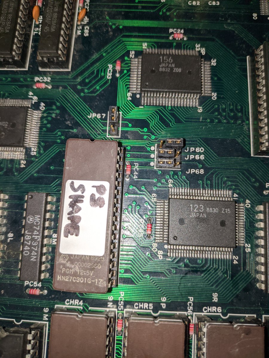

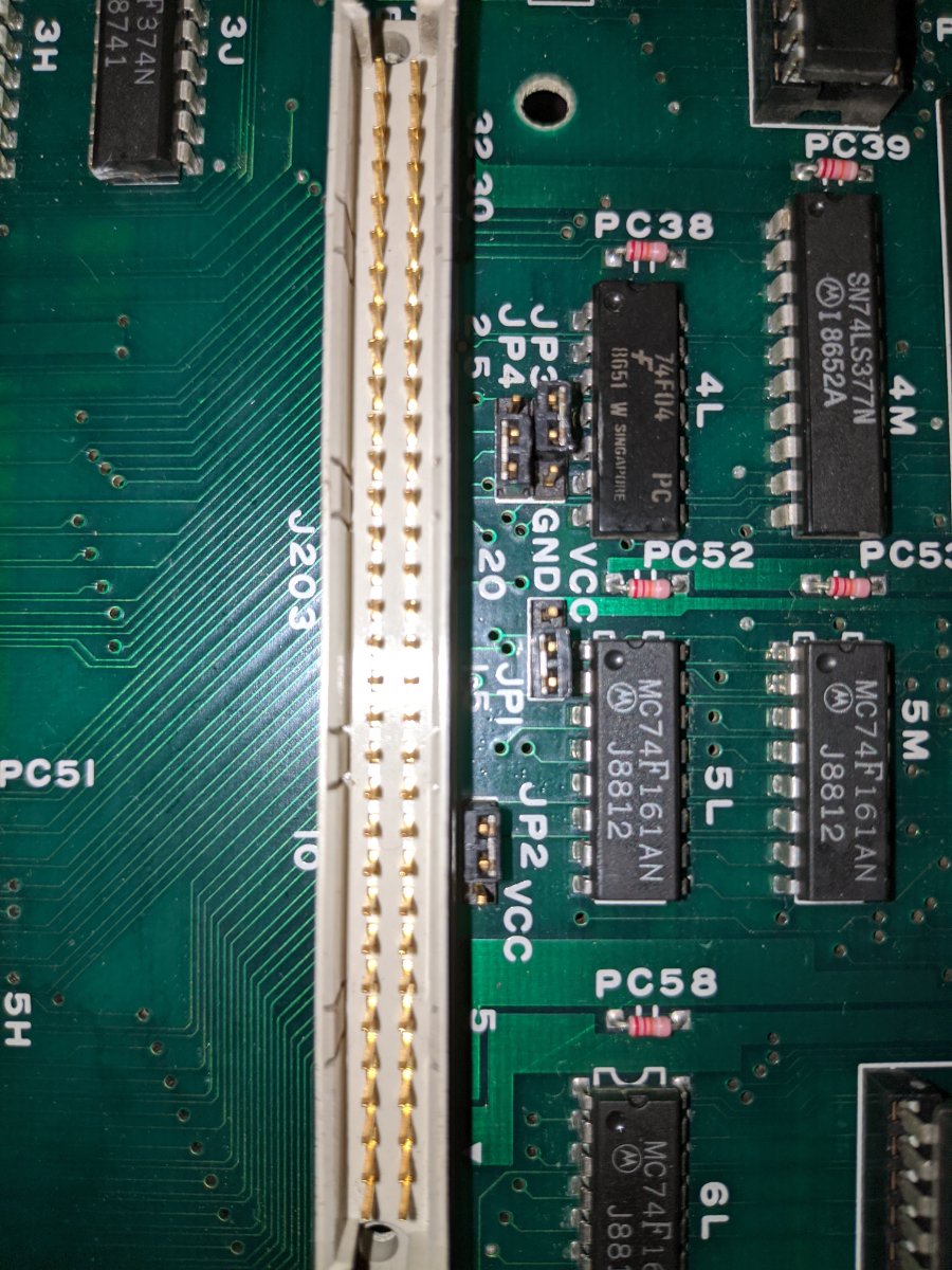

Adding to knowledge base here. But these are the issues I’m seeing on my Marvel Land donor (not multi), in case anyone else sees the same.
Your error is in the area C9xxxx which is also ROZRAM. You also need to check those 4 SRAM chips and find which one is BAD.
I also have the tip issue.
