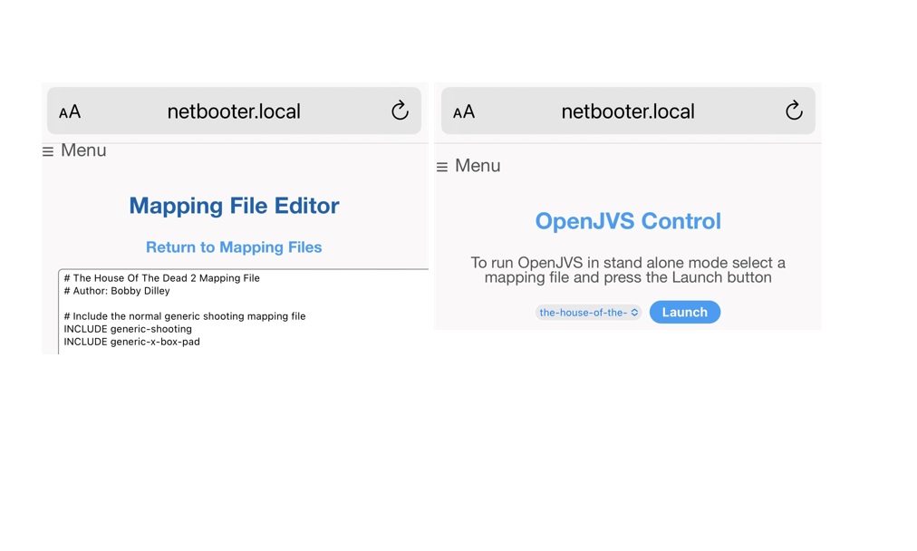

That being said, if I assign the gun alone to the game, I can't really press the test and service button now can I? Ok on the naomi directly I can but what about the start and coin !? What do you guys do? you have another controller plugged in ? then how to you assign both to the game? I have tried the following and then applied that mapping to the game and I can insert coin and start the game but then of course the gun stops to work ... :muted:
It would be nice if the openJVS could plug into the existing Sega I/O and show up as a secondary I/O ... ( the game does not load when I try that?).

You should remove the line where you attempt to include a device mapping file in a game mapping file, they are different things and that will likely cause OpenJVS to not function properly. If you'd like to have another controller also show up as player 1, you are able to put PLAYER 1 in it's device mapping file to cause it to always be that player. Alternatively you can have it as player 2, and modify the game mapping file to use the player 2 controller for certain inputs (although for the majority of light gun games, the in/out screen aimtrak buttons should suffice). Test/service are non player specific, so you can plug in a controller as player 2 and it will allow you to use the test/service buttons on there.
