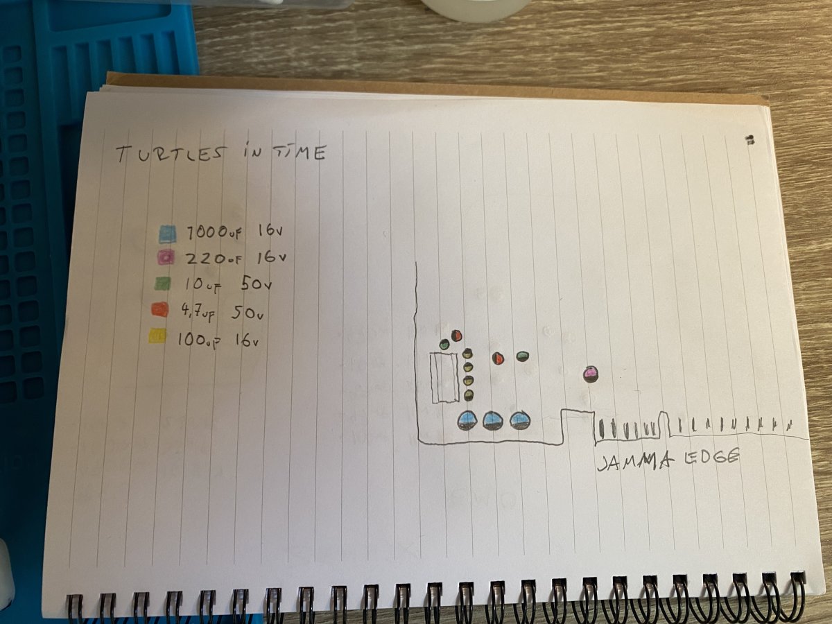

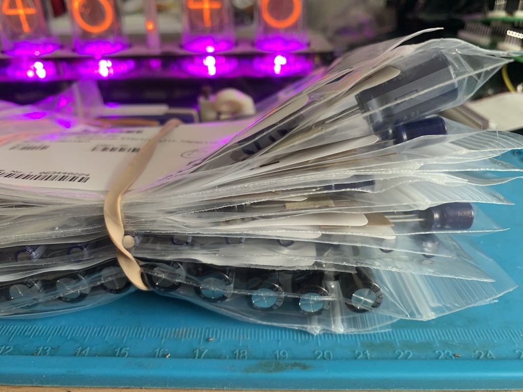

I did Turtles In Time last week. Here is the capmap
Capacitor Diameter Qty Location
0.47uF 50V 5.00mm 1 C10
3.3uF 50V 5.00mm 1 C23
47uF 25V 5.00mm 1 C22
330uF 200V 22.00mm 1 C5
470uF 16V 10.00mm 1 C20
1000uF 35V 12.50mm 2 C18, C19
4700uF 10V 16.00mm 4 C11, C12, C13, C14

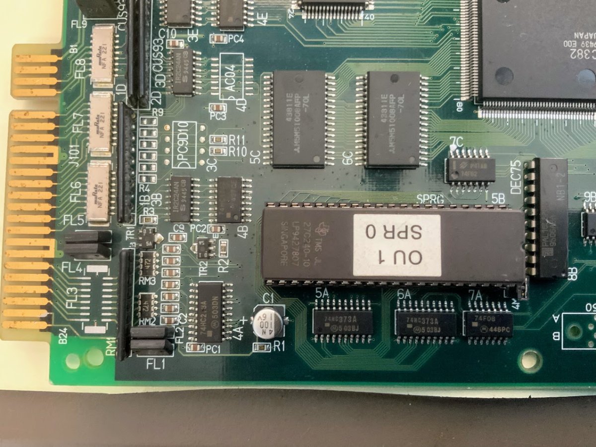

| Capacitor | Rating | Type | Lead spacing or dimensions |
| C1 | 16V 470µF | Radial | 5mm |
| C2 | 16V 10µF | Axial | 12mm x 5mm |
| C3 | 16V 10µF | Axial | 12mm x 5mm |
| C5 | 16V 10µF | Axial | 12mm x 5mm |
| C6 | 16V 220µF | Axial | 16mm x 8mm |
| C7 | 16V 22µF | Axial | 12mm x 5mm |
| C8 | 16V 10µF | Axial | 12mm x 5mm |
| C16 | 16V 470µF | Radial | 5mm |

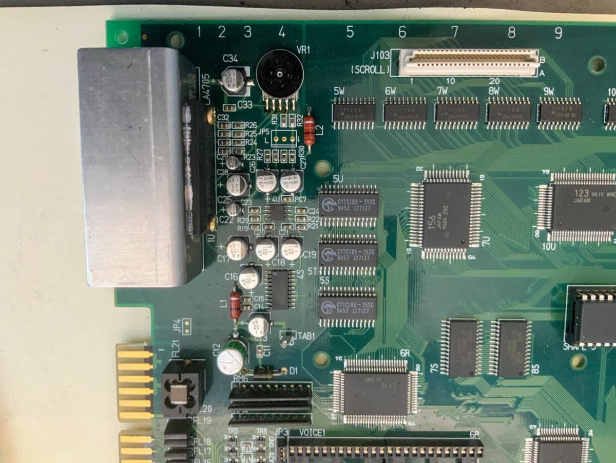

| C2 | 16V 10µF | Radial | 2mm |
| C7 | 16V 100µF | Radial | 2.5mm |
| C8 | 16V 100µF | Radial | 2.5mm |
| C9 | 16V 100µF | Radial | 2.5mm |
| C10 | 35V 4.7µF | Radial | 2mm |
| C15 | 35V 4.7µF | Radial | 2mm |
| C16 | 35V 4.7µF | Radial | 2mm |
| C17 | 16V 10µF | Radial | 2mm |
| C18 | 25V 2200µF | Radial | 7.5mm |
| C19 | 16V 47µF | Radial | 2mm |
| C21 | 16V 100µF | Radial | 2.5mm |
| C22 | 16V 100µF | Radial | 2.5mm |
| C23 | 16V 100µF | Radial | 2.5mm |
