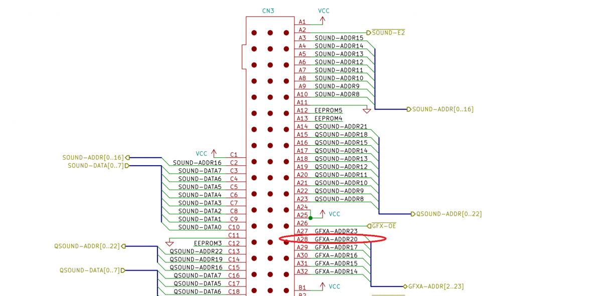

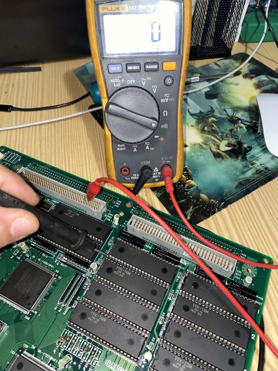

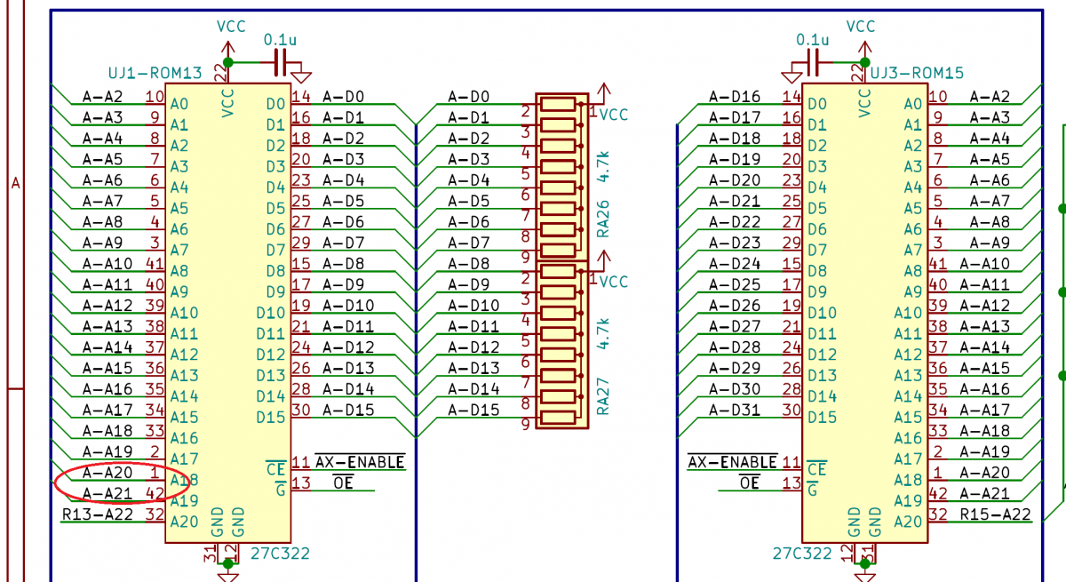

Checked all mask EPROMs, zero issues, so I started to check schematics online to trace the 2 pins the 4MBit EPROMs are not using.
GFX Address A20 is not available when using these 40 pin mask EPROMs.
Same with gfx address A21
By tracking the traces, indeed, this address is not available (duh).
So, I decided to burn these 4MBit EPROMs in M27c160s. Doubled the data, just in case. Tried jumpers as OSSOOSSO-OSSOOSSO and SOSOSOSO-SOSOSOSO.
Exactly the same freaking result. I reinstalled the original mask roms and decided to store the pcb until I have either another board to test or somebody with a 19xxjr2 pcb willing to share the B Board revision and the jumper settings.
