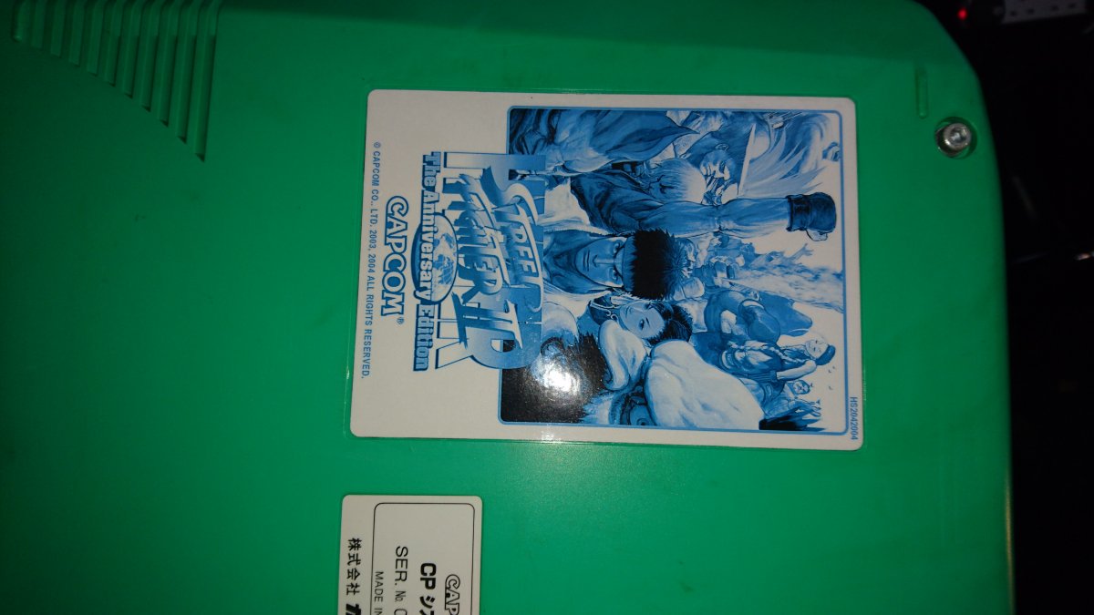

I have a concern with the hyper street fighter anniversary edition, how would the process be without the additional plates, because I made the conversion of one and I do not have the voices of the people of the game that would be the only details

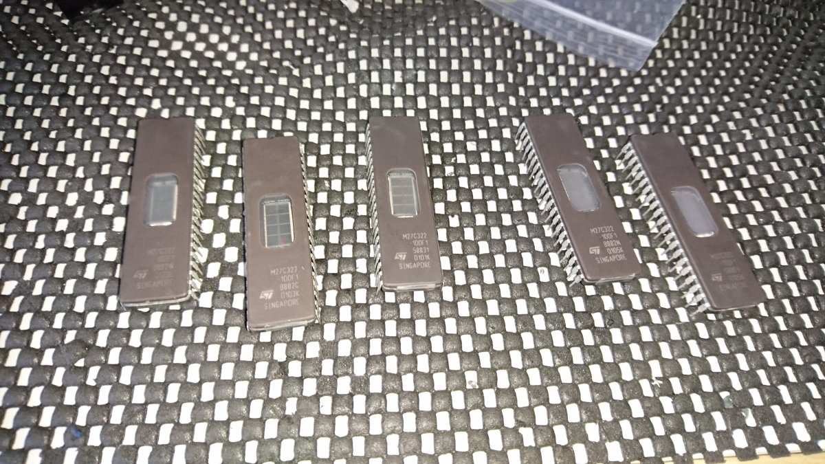

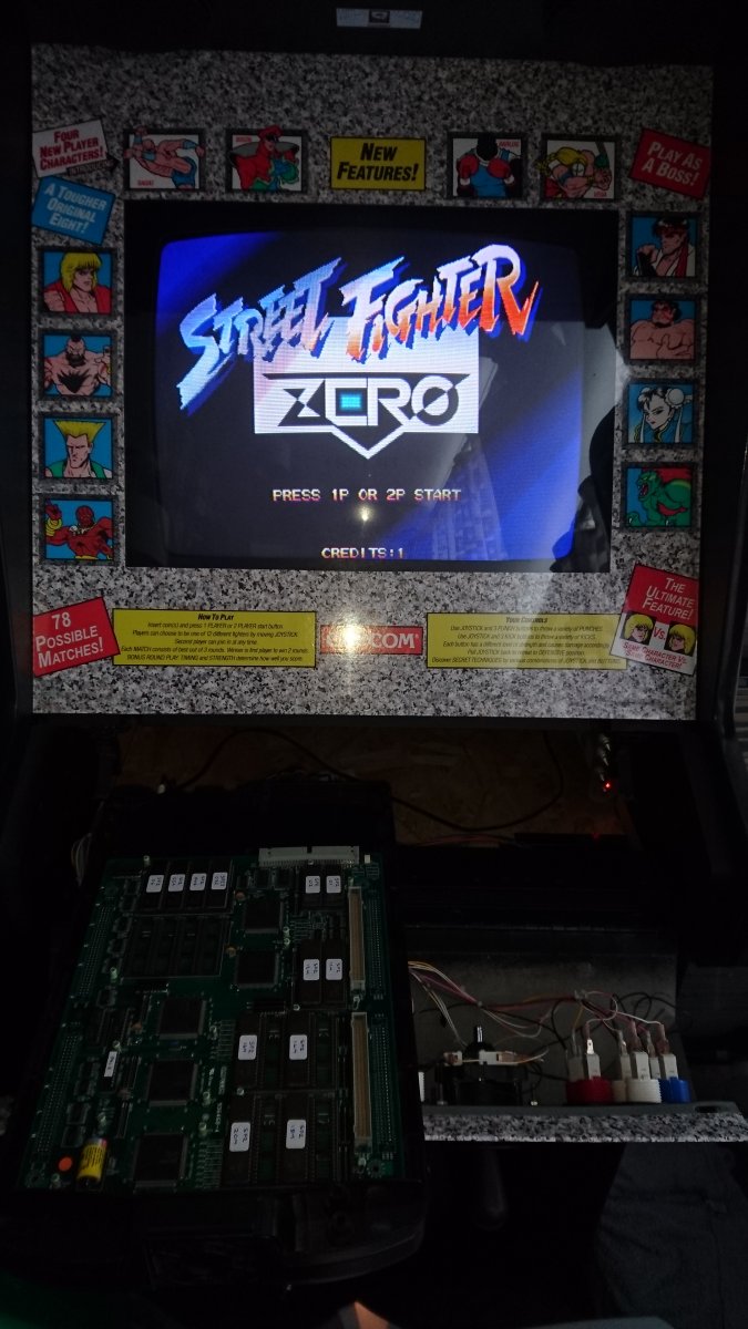

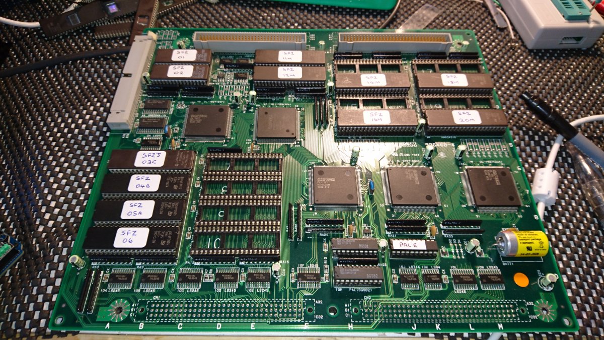

Good write up this it helped me with my conversions of 2 of my favourite games, i had a spare revision 4 board which had Super Street Fighter 2 New challengers on, just converted it to Street Fighter Zero Japan, I've used original code as i wanted a battery, just loaded the keys in through the CN2 connector to de suicide the board, burned a Pal E chip and the board works flawlessly, I'm now Starting on a Marvel vs Capcom on a rev 7 board with battery, just awaiting a batch of 27C322 roms to finish the job.

T56 EPROM burner ok for these conversions?
Yes it will, the only issue i found with the t56 is on some of the 27c322s that are getting on a bit they don't programme to well, well they do you can get around it by adjusting the write voltage, you usually know if a chip is going to be pain to programme by how long it takes to erase, i had 2 x 322s that were old took nearly 2 hours to erase them, the programmer checked them as blank but failed to programme halfway through, chucked them in the eraser for 2 hours and they programed just fine with different voltages.

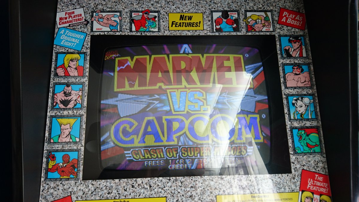

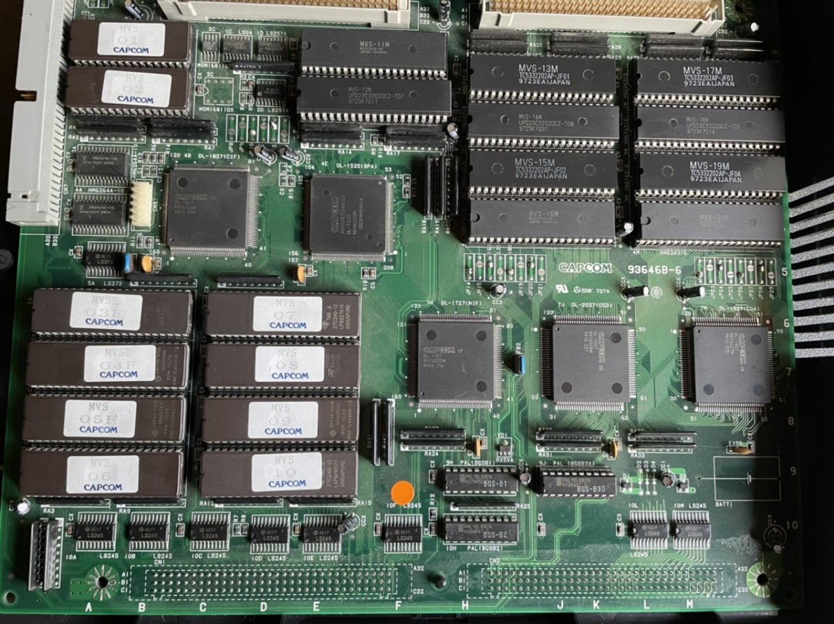

Finished my Marvel vs Capcom Conversion, the board was originally Xmen vs Street Fighter i had 2 copies of that game so made sense to change one, i love Marvel vs Capcom such a fantastic game and the best music of all these capcom vs games, I've even found a batch of original new Maxel Batteries like the original 09-21 date stamped so happy with that did think about putting a battery holder on but thought better of it.

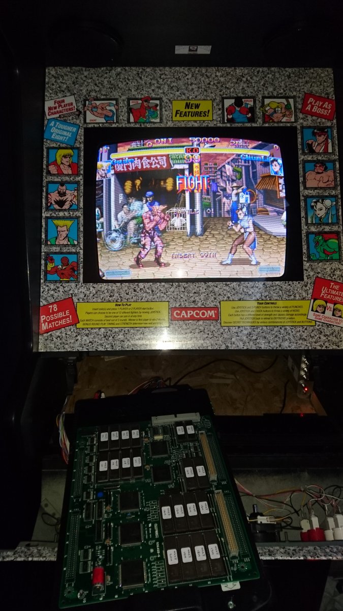

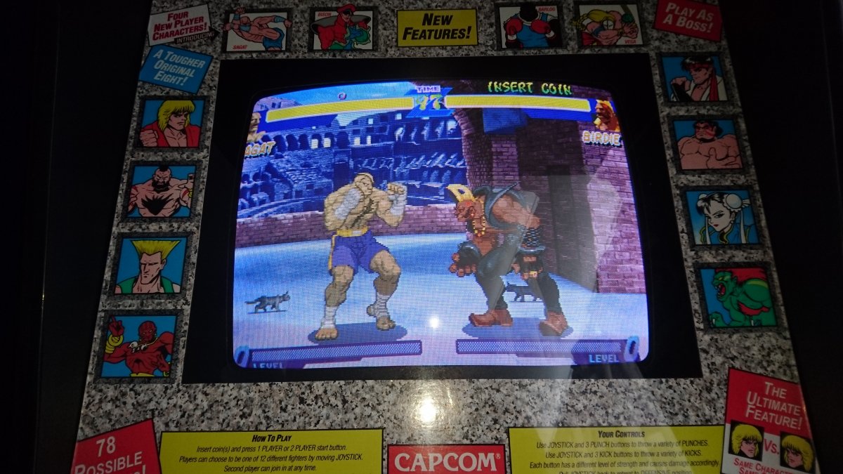

Its been a slow afternoon so thought i would clean up my Hyper Street Fighter 2 board and do a region change from Asia to Japan, i bought this board as a conversion from fleecebay years ago at a price i might add 'fool and his money etc' but really wanted to own this game bad lol this was long before i knew how to do conversions or cps work, to be honest i don't know who did this conversion but it was half arsed piss poor conversion, most eproms had bent and soldered on pins or rusty also the eproms had no window stickers and none of the eproms would verify with any Asia hsf2 rom sets so don't know what version it was coded with, anyhow I've erased the good eproms replaced the broken ones with new ones, what's interesting is in sockets 1 and 2 it has mask roms yet those verify, I've added a battery too a bit old school and boarding on ridiculous considering the options available now but i like my cps2s to have batteries, anyway all working and now running a japan rom set and a lot cleaner looking.
