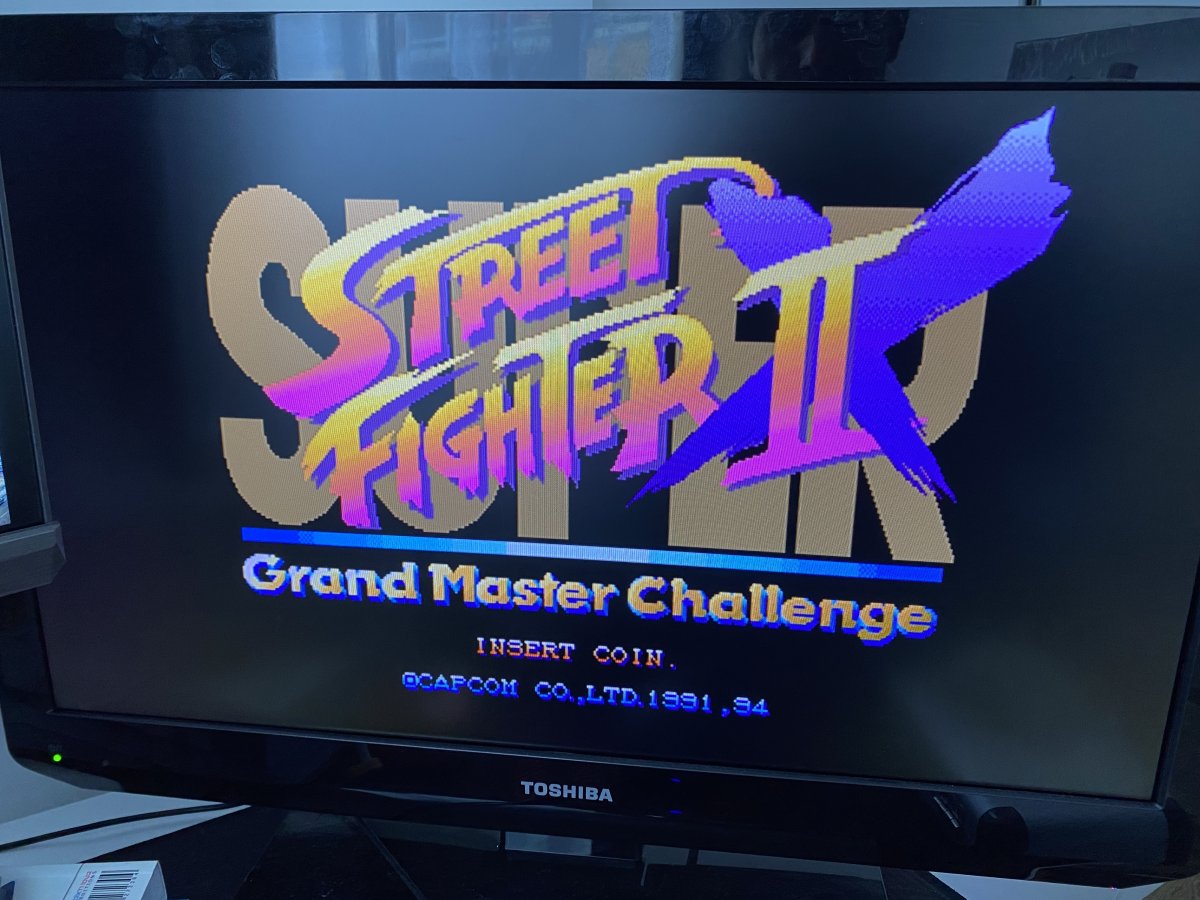

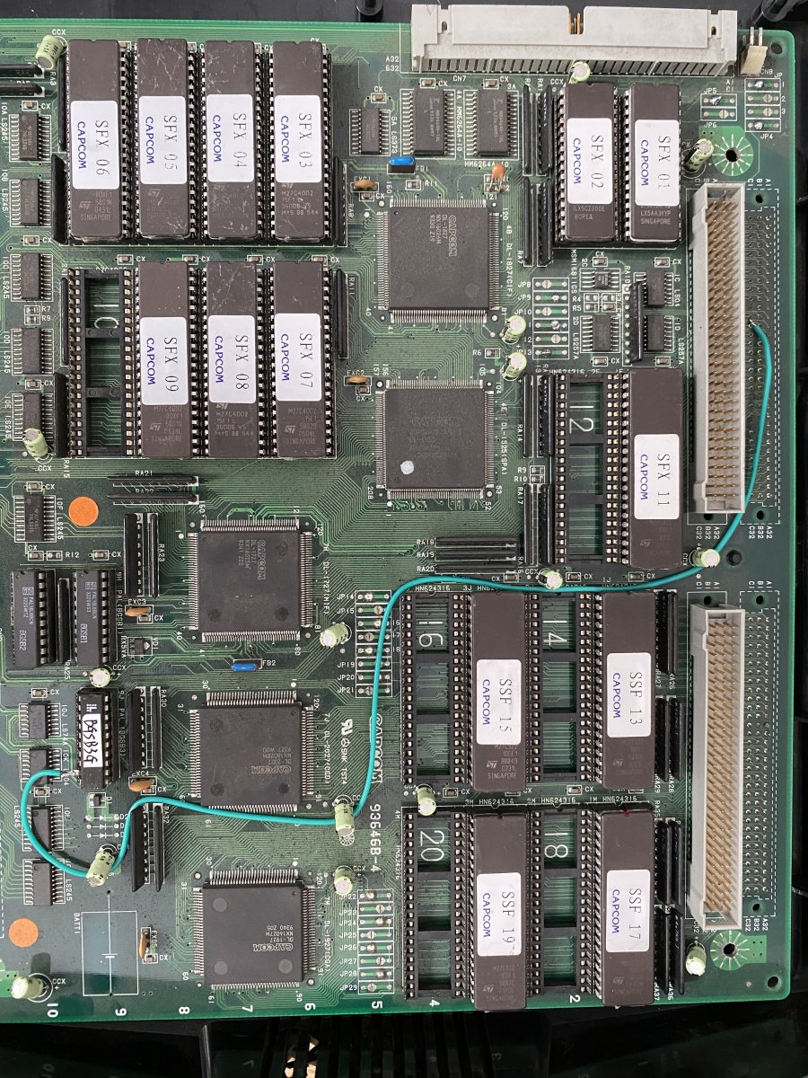

Guys,
I need your help, I converted a MSH into a SSF2X, I bought the romset pack to Aliexpress.
My board is a Rev 4 one.

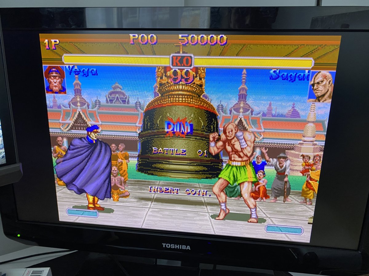

The game is working fine, graphics are good so no issue on this side I guess.
Sound is not working correctly, voices are ok like Round 1, Fight or Hadoken etc but music is garbage.

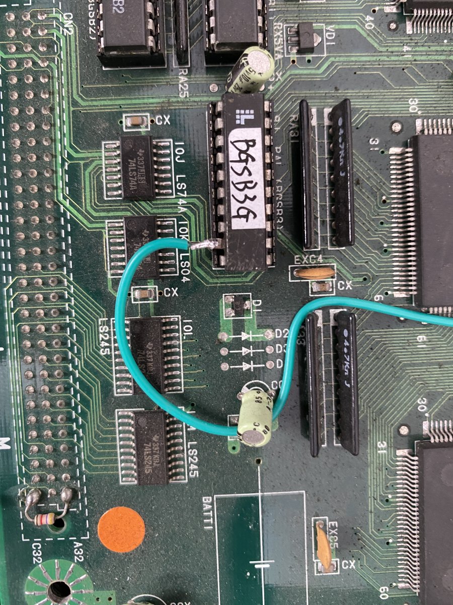

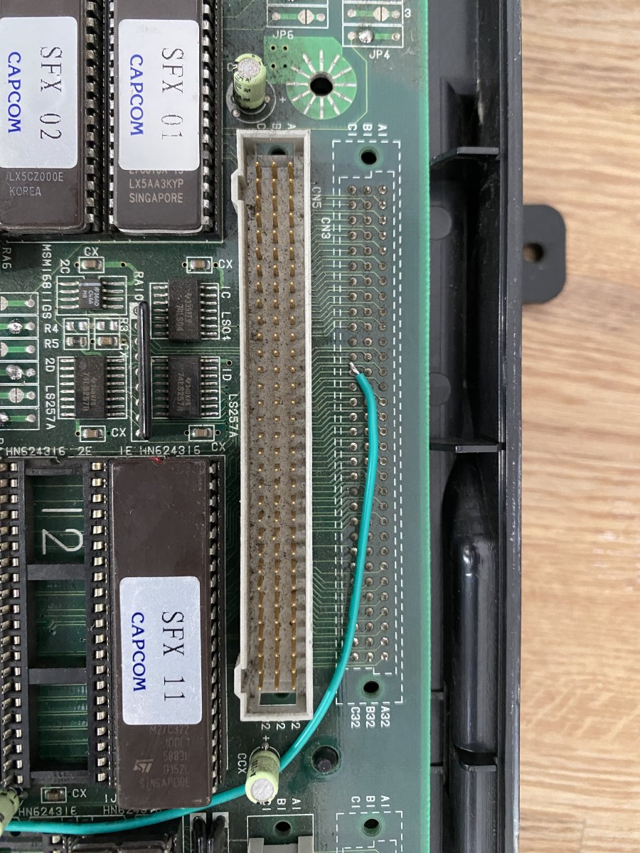

I'm not sure what I missed, I installed the jumper wire from PAL BGSB3G pin 9 to CN3/13 but still the music is not working.
I tested on romident Eproms 1 & 2, they are ok.
My jumpers settings are as follow: SOOS_SO_OSOSOS_SOSOSOSO_SOSOSOSO
Any help much appreciated.
Jon
