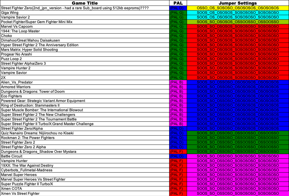

use jumpers config same as progear and use a PAL G

PAL G...if i don't have in the Puzz Loop 2 B board, could be bought somewhere (or i can just buy a GAL16V8 and burn it (but in that case, burn it with which data??))?
