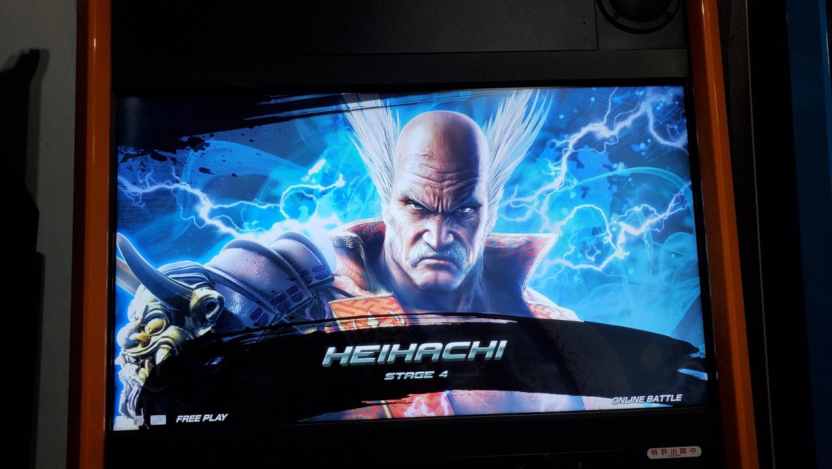

Tekken 7 Round 2 - Crashes on the start of the 4th match, when the Heihachi video starts. I have attached a picture.

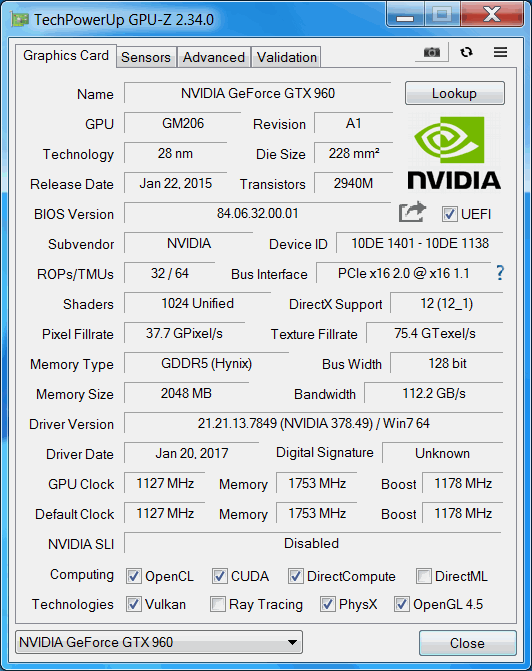

The Elsa 960 out of my after school activity unit doesn't boot in my TTX3 units. Doesn't get past the post. If you can be bothered, i would be curious to see the GPUZ of that960 video card.
Your TTX3 has the E9A46I3E v1.0b23 092614 bios file from figureheads right?
Of course, you've helped me out so much that it's the least I can do for you. So here is the GPUZ from the GTX 960 that I own. It looks exactly the same as the one you have in your system. I noticed that both of ours are the same exact bios. I've also attached the bios from mine. And yes, my machine was originally a Figureheads A, which I believe is later than any other system firmware. I wonder if that has to do with anything. I wish I knew how I could extract my Figurehead A firmware easily. When I get a chance, I will put the 960 in my other X3 machines that were Lord of Vermillion or Puzzle & Dragon.

Thanks for posting that. It looks like the newer bios on figureheads might have some UEFI support cooked into it. If I had to guess i'd say it's not going to work on your LOV and P&D.
You were 100% correct that the GTX 960 from my X4 DID NOT work on either my LOV or P&D machine. So I guess the later firmware has something to do with it.
