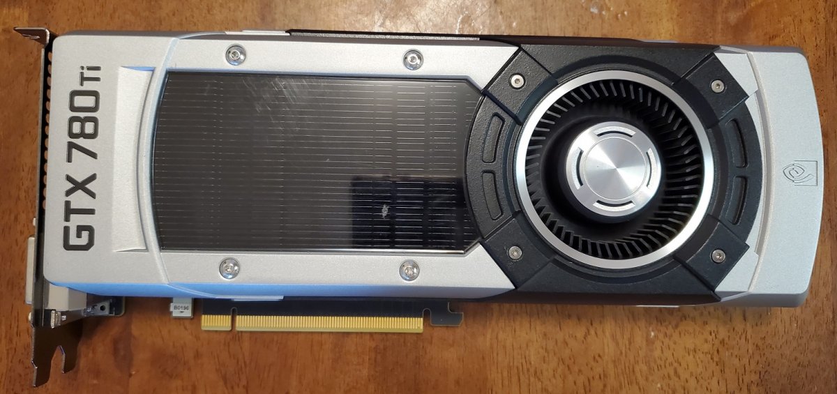

I know for sure a 780ti will work in the X3 using different multi. The one I used is this one. I had to reflash the bios with a non uefi one of course. This one is made by PNY.
Well, my 780 also worked with an older multi, even with fighting ex layer (though it didn’t have t7). @300wins if you upgrade though please lemme know if yours works with those 2 games!
Do you have a link to the non UEFI bios? I have the same PNY 780Ti with an EK waterblock from an old build. Planning to get an X3. I think i'll call it "X3 Overkill" :D

GTX 780ti asus with MSI non uefi bios working great
