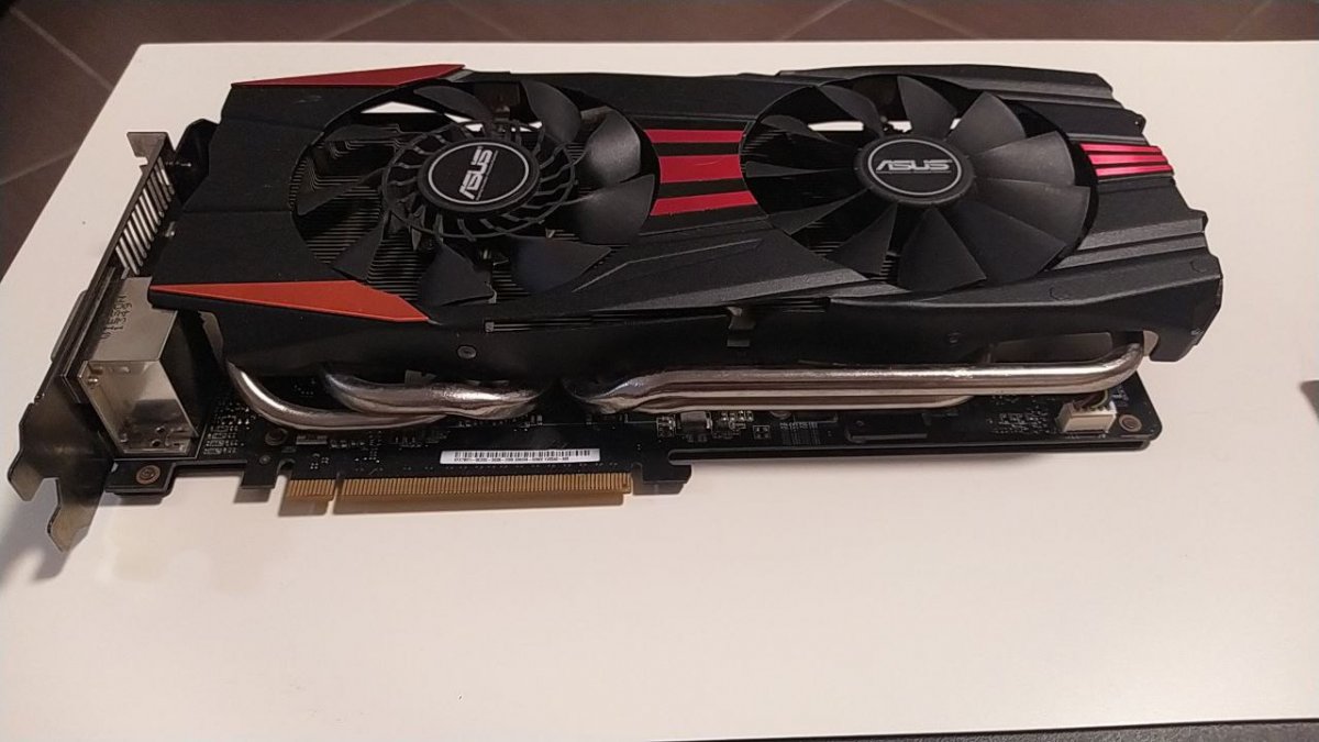

link for MSI bios on my ASUS 780Ti
https://drive.google.com/file/d/1cYrhQkbJ0oV1YSl6ZHyHEasNeB4m3iIn/view?usp=sharing

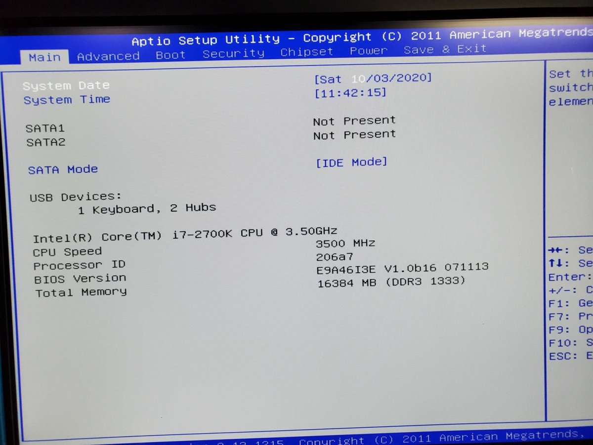

first I have to check the bios because if mine doesn't support the i7-2600k i don't understand why he can support i7-2700k
can you show me your bios version?

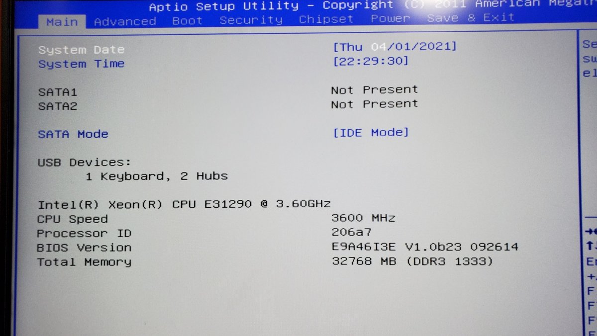

So here are 2 different X3 with 2 different CPU and 2 different bios revision. One has a Xeon processor and one has an i7-2700k. I forget what the i7-2700k used to be, but the X3 with the Xeon processor is a model 407 (Figurehead A) machine.
Hopefully you figure out your problem.
