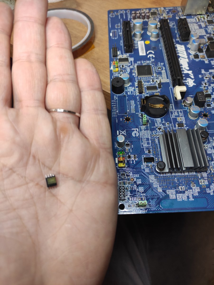

don't worry, I have 2 type X3, I try on one and tell you the results
I make a copy of mine first, if something goes wrong I can desolder it and flash with a programmer

Murray when I put your bios on mine, the system start and reboot continously, with a friend we are try to investigate on it
You need hardware way to have a full 8mb dump, anyway the 2mb core dump will have to be functional too except if you have failed to patch the correct updated microcode. When i have the b16 dump i can make some tests and reports here my experience.
