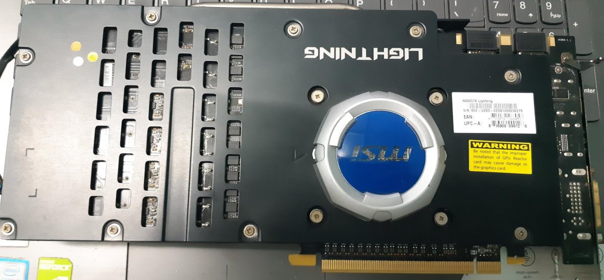

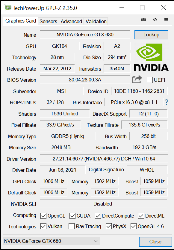

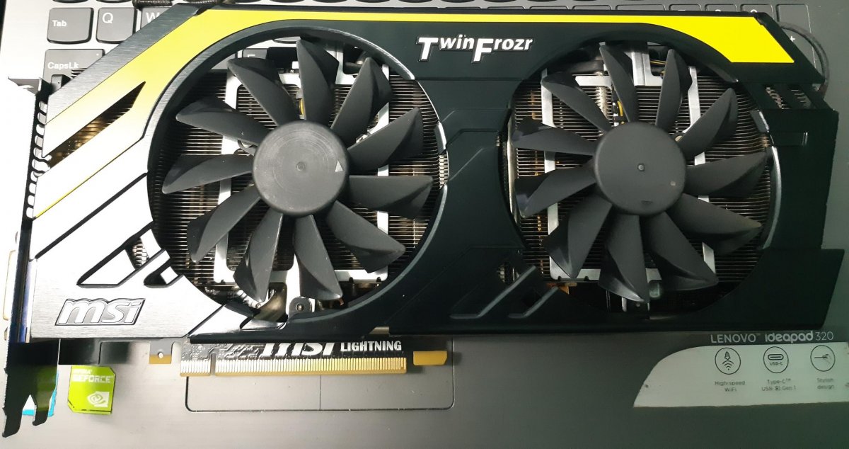

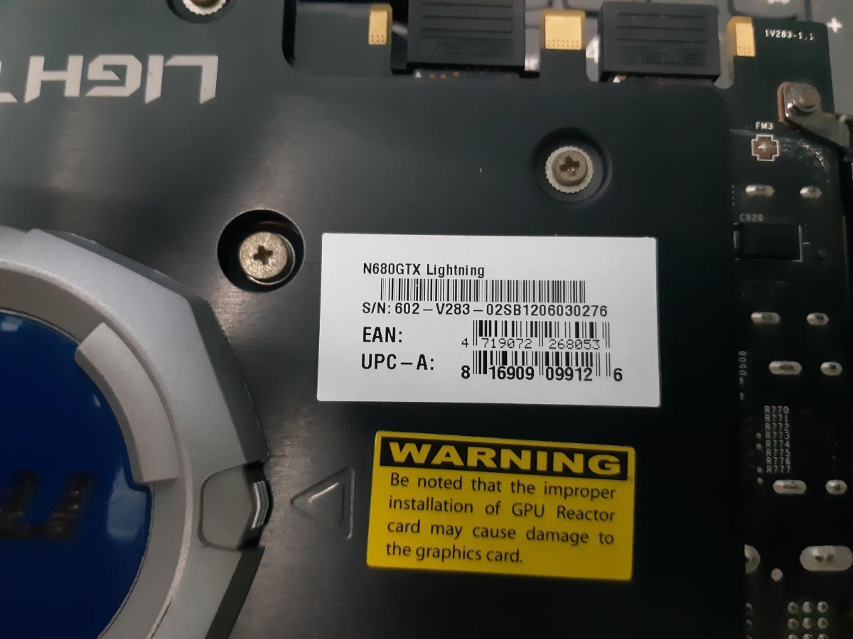

I have obtained a 680 card and it doesn't work. stuck at a black screen with a flashing prompt and the ttx3 restarts after some time. I haven't flashed any bios to it yet. hoping someone can recommend what bios i can use to flash this card. Thanks.

i've flashed the card and i needed to use the -6. it still works fine on the pc. when i plugged it in the ttx3, there's 5 beeps and no image is displayed. is it not compatible?
i've flashed back the card with the 3A firmware. it just hangs at the white ttx3 logo screen. i will try the firmware you posted. i actually did not connect the case fan.
i found out it causes the black screen with a flashing prompt when i reinstall the 660gtx card without the case fan.
how do i reflash the card when they die with a 2nd card? how will nvflash flash the correct card? i have a rtx 2070
the new firmware still gets me stuck at the logo screen. i installed the 660gtx and i get stuck too. i guess something else is not right instead of the graphics card. may I know what causes the TTX3 to get stuck at the white TTX3 logo screen?
update: i've got it working finally. flashed to the original 3A firmware. the white screen is due to the bios security settings being reset.
the original black screen with the flashing prompt is due to the case fan not connected. this card works without any bios flashing needed.
i got it working finally. it was just the case fan not connected yesterday. i flashed it back to the original 3A firmware and set the hdd security again. finally works.
