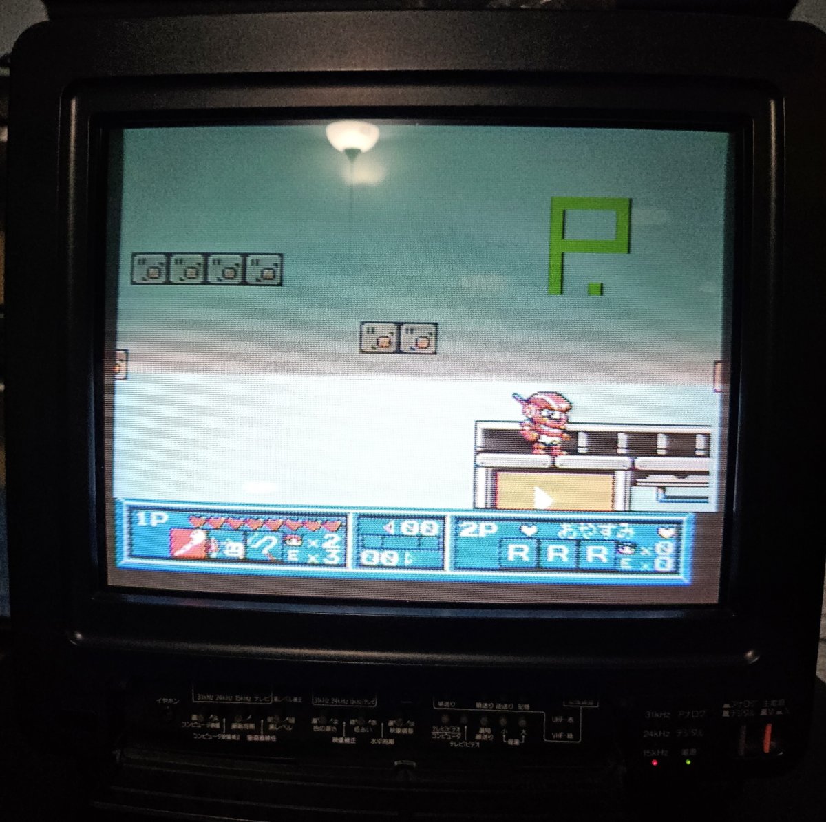

Hi, I got this x68000 monitor CZ-600DB recently. I hooked it up with NES to the composite video (yellow) and audio (white) jacks. I got the picture but the "P." won't go away (see attached picture). Did anyone have this type of monitor and have this issue as well? Maybe I need a remote to turn it off?

😁 The monitor seems to work fine now. It's only that the channel indicator won't go away. Did you have the same issue?
Nonive never seen that p before. Theres a japanese manual for it.. you can use google apps to translate them?
You need to have the remote control to turn off the overlay. :( I have a remote control -- if I can "scan" the IR codes I could post them. anyone know how to do that?

If you have the X68000 too, the computer can control the monitor if you connect the remote plug (TV Control cable) on the back of both... Just press certain key combinations on the X68000 keyboard to send commands to the monitor.
