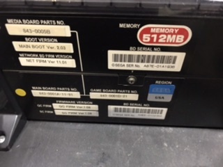

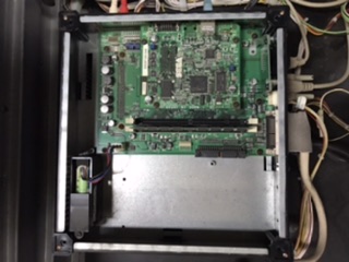

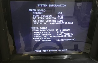

but concerning the dimm FW mine seems to be 1.0 RX 850
normally chihiro 3 have 3.03!!!
so how to upgrade from 1.0 to 3.03 then 4.01 then 4.02
That is for Those Naomis, Triforce and Chihiro that have a NetDimm. Yours is a type 3 and has no NET DIMM.
Just connect your Chihiro via Network cable to a PC as explained in several threads and upload the firmware as if it was a normal game. It will then do the update.
