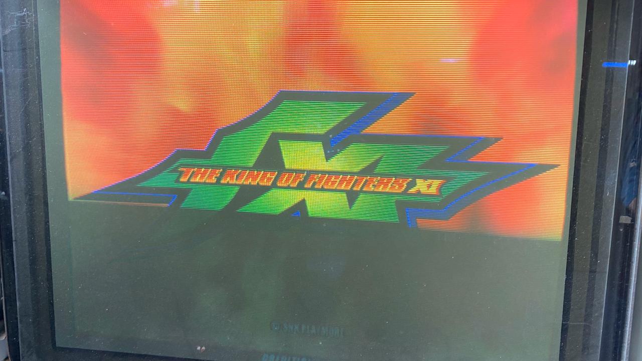

@Murray first I tested with bios H - Japan, after I tested w/ the latest multibios, all the tests was made w/ japan region I didn't tested with other regions configured.
Tomorrow I'll test the time hack and do a video to ilustrate the issue.

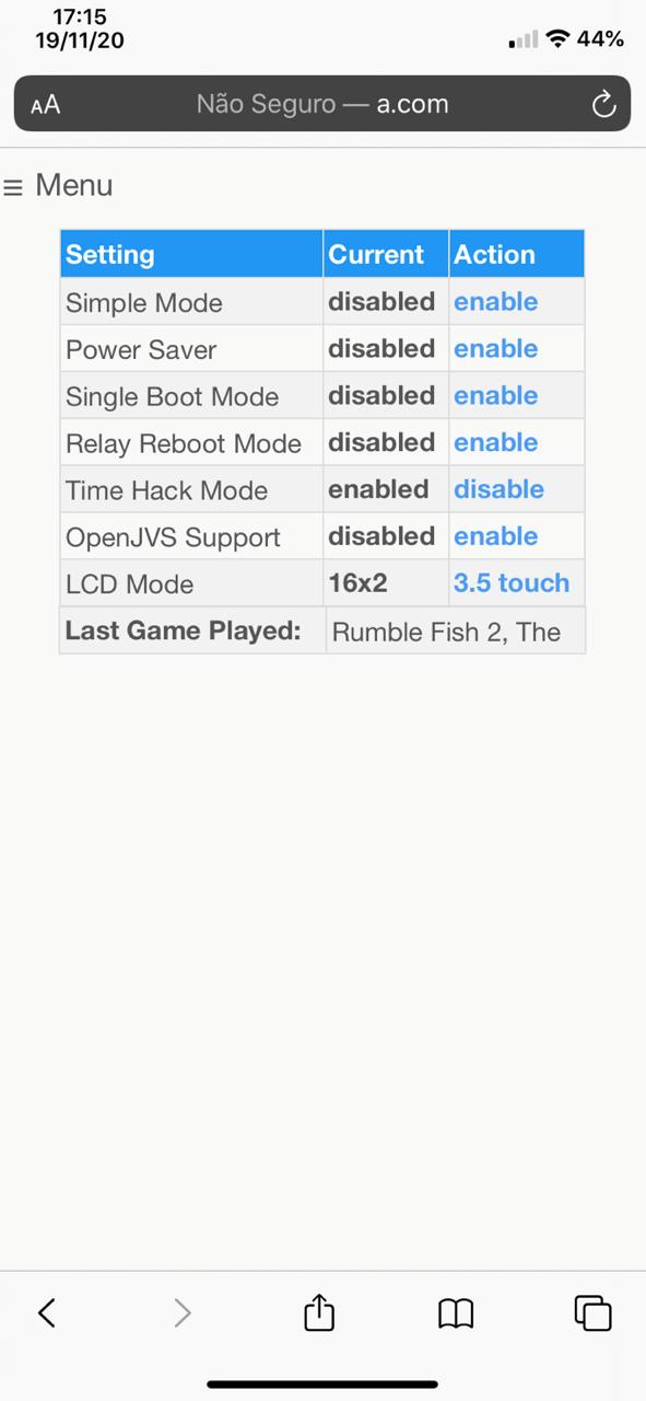

@Murray same issue, without pic and time hack enable, tested w/ 2 cards same problem.
Gonna post my setting and a video.
I really don't know what to do next....
Thanks again !
Thanks again !
I can't say for certain, but it awfully looks like a JVS I/O issue to me.
@GarouSP Like @mathieulh has said, it sounds to me like you might have a button stuck down on your IO. Can you try a different IO or no IO at all?
You could also go into the JVS test and make sure all buttons are zero and that the IO generally works properly.
Is it the official jamma to JVS one, or a clone?
@bobbydilley @mathieulh If I got an stuck test button I think that all games should enter in this menu loop, only atomíswave do this, Naomi games works flawless, and it is an original sega IO, I didn’t check the switches at the service menu, I will check to rule down one more thing and change the IO for another one to check that too, to be honest right now I don’t remember if there is a service button on the IO, I use the service button from the Naomi board.
So far I have done...
Changed Naomi board.
Changed Netdimm board.
Changed the microsd and burned the image a couple of times.
Removed null key and activated time hack.
Maybe there is something that I could do but I can’t imagine.
Thanks guys for the help!
Can you run an Atomiswave game without the IO board connected ? (They can run with no io board) and see if you still have the issue?

@mathieulh tested w/o the io, worked, but I’ve tested with 3 different ios and all of then gave me the service menu loop.
I know that the io have a jumper to change button configuration, one position CVS 2 doesn’t boot, another boots, gonna test both settings to see with changes anything about atomiswave.

@mathieulh I got an IO borrowed for test, even doing this variation in analog controls, all games worked, no more service menu loop.
My 3 ios have the same problem, strangely only in atomiswave games, at least now everything is fine, a little more tests to finish.
Thank you guys for the help!!!!
