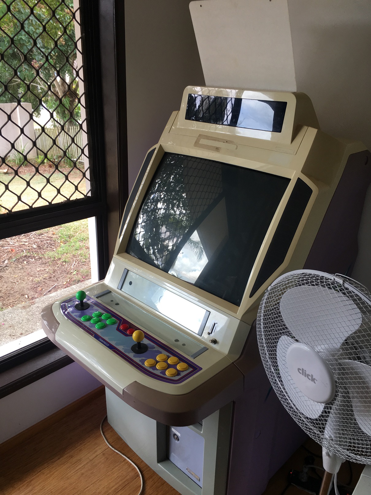

Going from those pictures you took, it looks like someone at some point modified the control panel with American style joysticks and buttons. Which means it will not accept Sanwa or Seimitsu joysticks anymore, Japanese style buttons should still fit though.

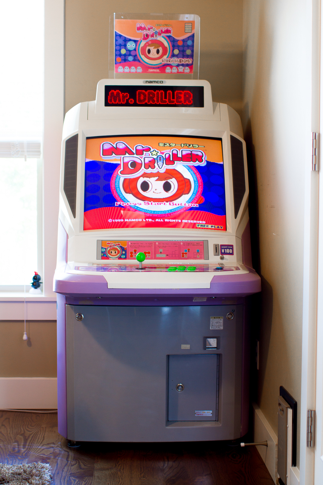

Here's mine :)
Derp, yeah, I didn't really look at the photos on my phone. That's not a modified panel, that's a whole new one, with fully Americanized button layout too. :/
This is where the more exotic cabs are tricky, it's not hard to get repro Sega panels, I've never seen anyone doing Cyberleads. Your options are just live with American panel or get a custom panel fabricated, unless you can get really lucky with a find.
Personally I couldn't live with that panel, I'd take it off, trace it, scan it, and built up a new one to be waterjet cut. That's not hard. Little trickier to figure out joystick mounting plates though.

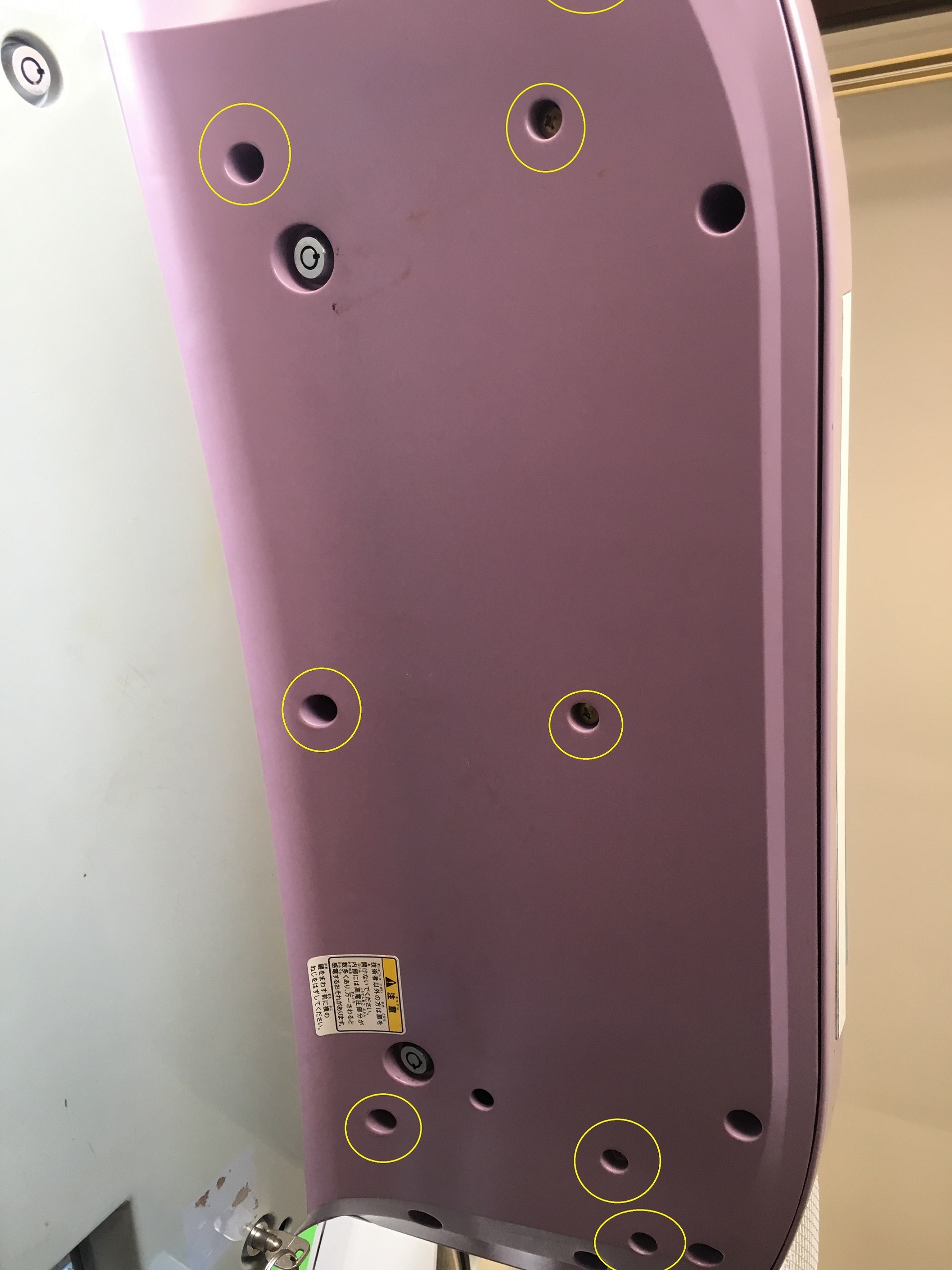

I took some photos of my control panel and how it attaches to the cab, so hopefully this helps get it open:
Underneath the control panel itself are a whole mess of screw holes, 8 of these are actually attached to the body of the cabinet that the locks are also attached to - the rest I can't see. I assume because candy cabs are designed to take different control panels that the screw holes are for potential other panels that may have been able to attach. But if it has a screw in it, remove it and make sure you remember where it came from!

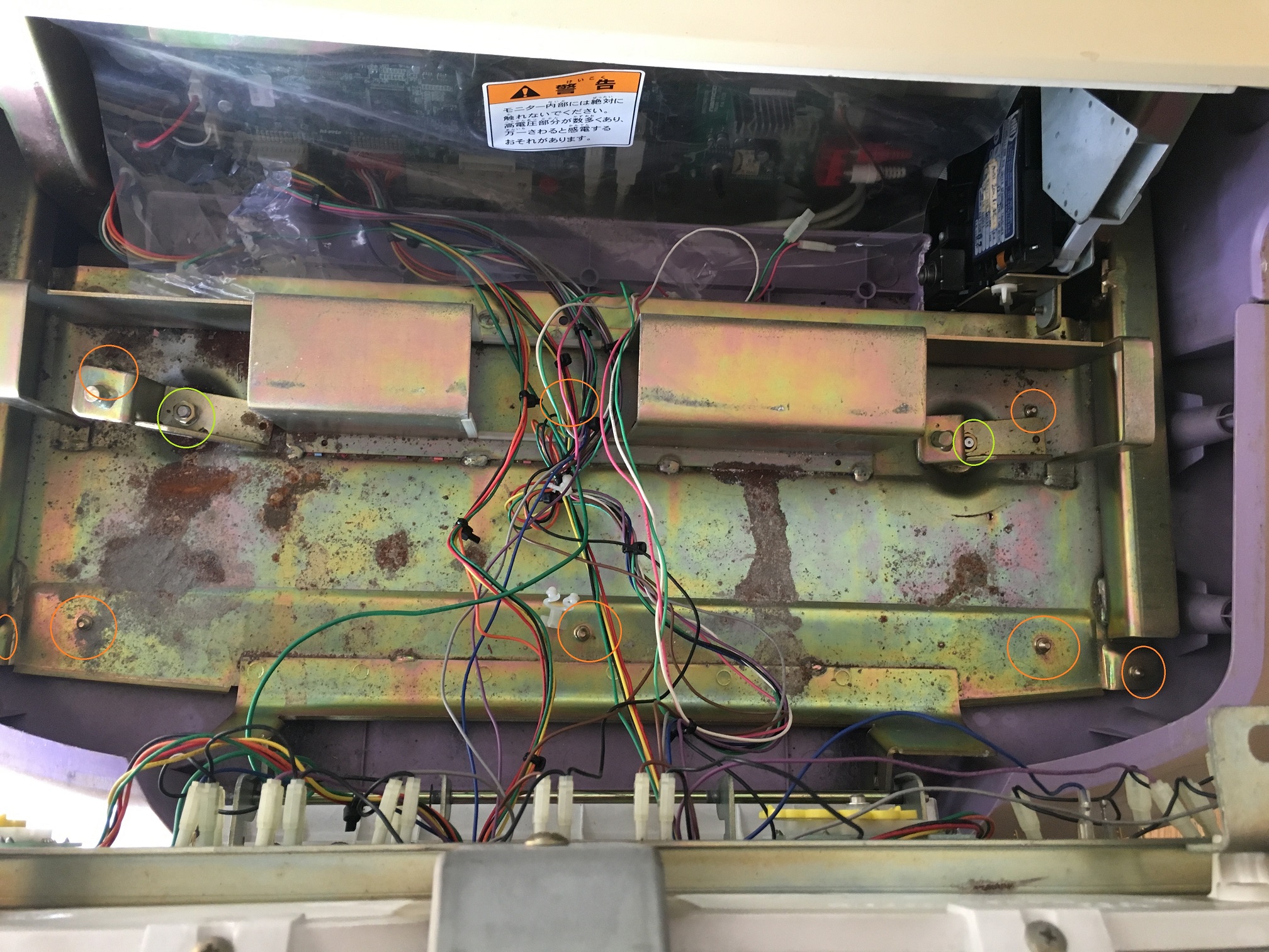

Photo here:
On the inside of the control panel I've marked out where the screws are attaching the plastic control panel to the body of the cabinet as well as the nuts attaching the locking tangs of the cabinet to the locks themselves. If you can remove the plastic control panel surround, it is then very easy to deactivate the locks so they cease to remain an issue. In this photo you can also see above the control panel on the left is the JVS I/O board which attaches to the DMD marquee on top of the cabinet, the amplifier board is on the right with the RCA leads attached - this has the volume control on it to adjust sound on the cabinet. I'm not sure if your cabinet still has either or both of these since it's been converted, but given the memory card readers are still on it, there's a good chance it does.
