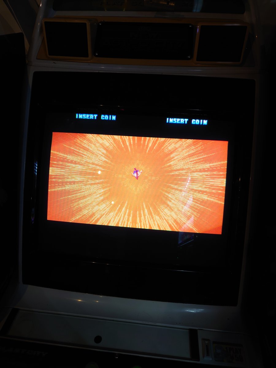

Freezes.
New generation ibuki's ending.
It's standard bios.
I could not reproduce this using the ultrasimms in standard mode.
@Mitsurugi-w good info. He's using regular Simms. I would assume that it was either a glitch or their simms are starting to wear out.
