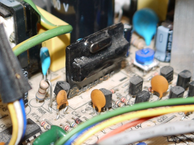

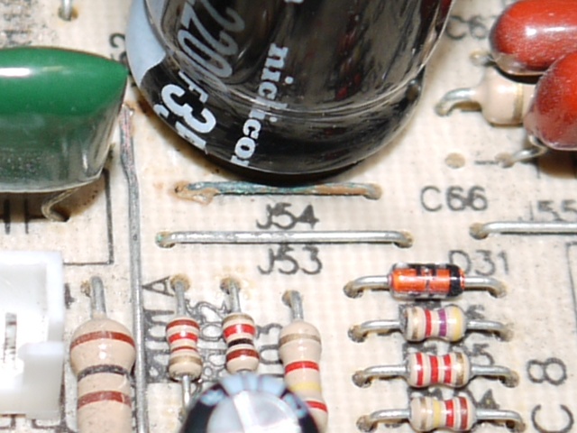

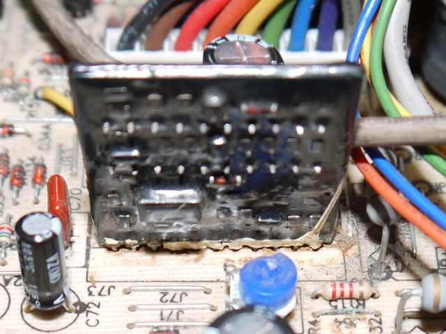

I've spent the last two hours recapping the Rodotron. Unfortunately, there's a huge issue with these chassis, something that wasn't obvious 15 years ago straight of the assembly line. Rodotron / Wei-Ya / whoever manufactured this junk used this orange glue to tack down a bunch of components. Well, it seems as it ages it becomes corrosive. See this jumper right below the cap:
Guess what was previously covered in glue?
And guess else what else is covered in glue?
All the custom parts!
I spent 30 minutes scraping off all of this crap, but I'm sure the damage has already been done.
Yep, I feel your pain as this is part of the reason why I don't touch them anymore. How does the soldering look on it?
Soldering looks OK. I can see why Jomac put a fan on these, there's an 1" x 1" area that has three large resistors and five large diodes that runs super hot. On the solder side the PCB has turned brown and the contacts are more or less gone. I had to jump a few traces.
Still waiting for the rest of the parts to come in the mail. If it has issues after recapping, I think I'll salvage whatever is worth salvaging and bin it. I don't think it's worth the time and effort to fix.
